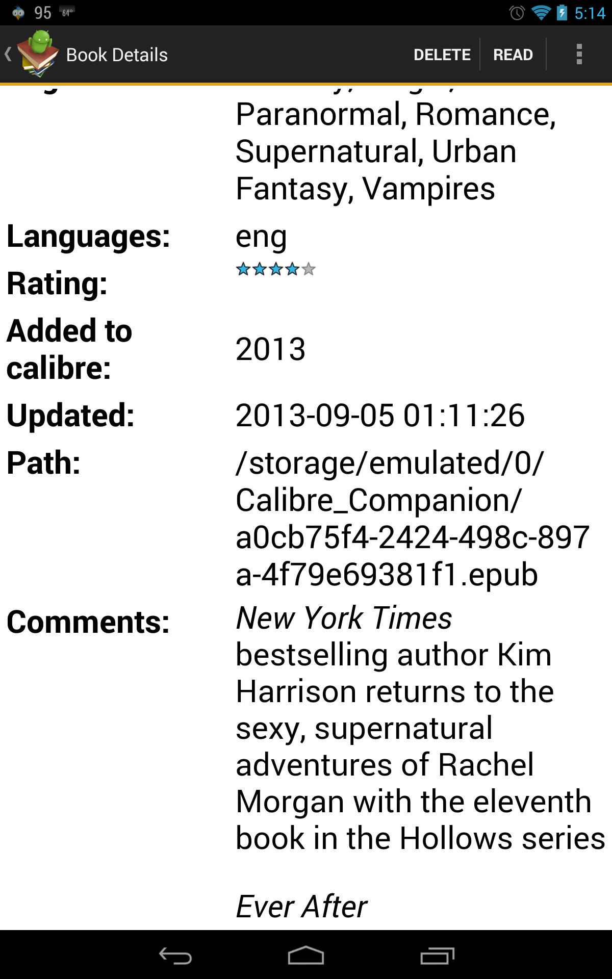

The two fixes for the HTML problems, respecting the system font size and the preference to turn off full html, have been released. See Calibre Companion V3.1.1 released
The handling of the large and huge fonts worked out great.
I was wondering if there is any wiggle room on the book details page to halve the gap between the colon in Comments: and the actual comments, see attached for how the gap looks on my device.

Originally Posted by DoctorOhh View Post
The handling of the large and huge fonts worked out great. I was wondering if there is any wiggle room on the book details page to halve the gap between the colon in Comments: and the actual comments, see attached for how the gap looks on my device.
The details are rendered in a table. The first column has the width
minimum of (some label width, maximum allowable space)
There is probably some other label that is using the max allowable space, pushing over the second column.
The change in behavior you see fixes a problem we were having where with larger font sizes even the smallest labels couldn't fit. The words were getting broken part-way through, such as in
COMM
ENTS
The maximum allowable space is now scaled by font size to prevent wrapping of single words, ensuring that the same minimum number of characters can fit in the column regardless of font size. The actual space used is controlled by the widest label on the screen. You should be able to verify this by rotating to landscape and seeing that the first column doesn't change size. All the additional space is given to the second column.

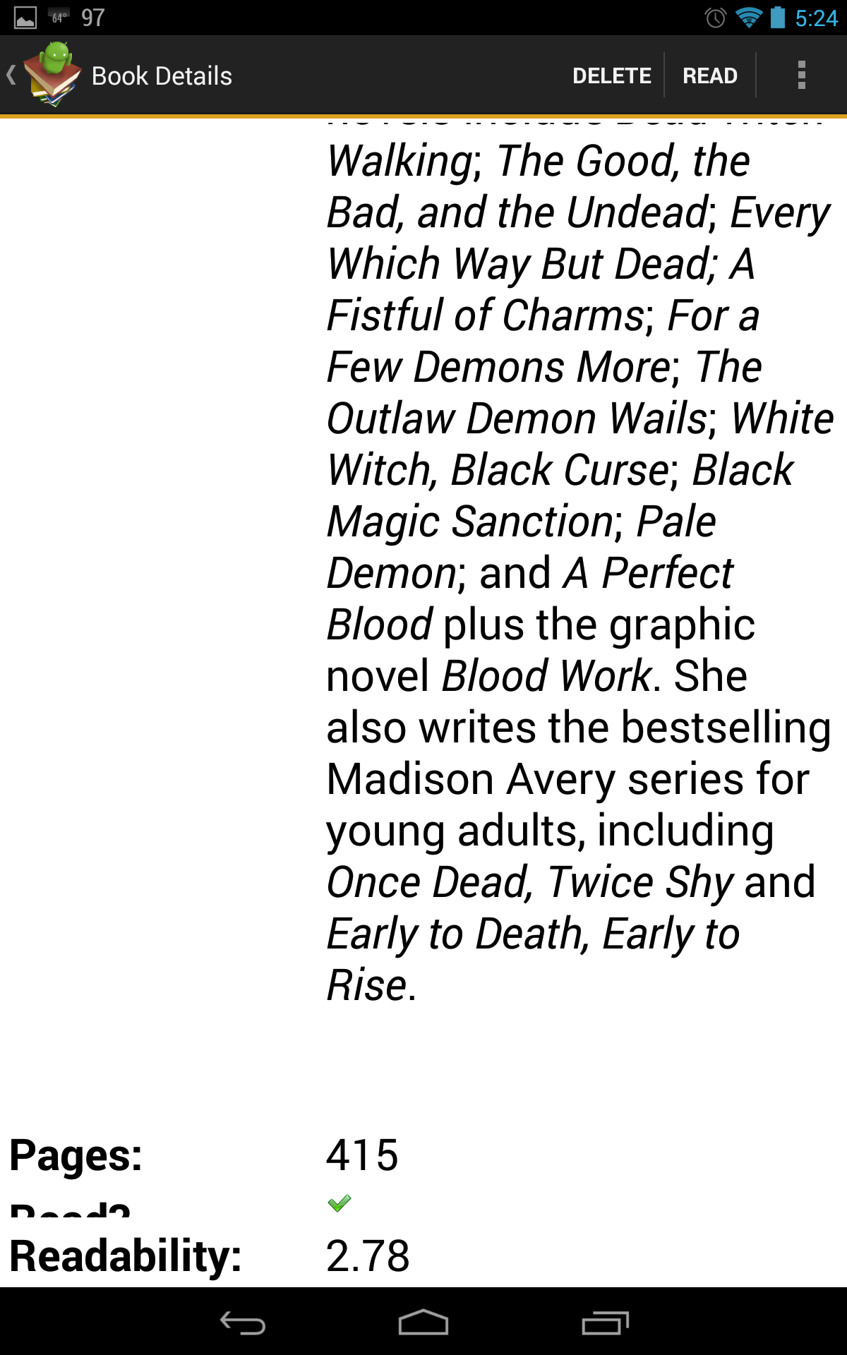

Additional question, could you investigate why the last item in my book details page covers half of my next to last item, see attached. Readability is covering most of Read?. This isn't new, it has been that way forever I just never mentioned it before.
Thanks for this update. Well done.
This is yet another side effect of changing the system font size. CC sets the height of the row to be the height of the check mark, which is too small when large fonts are being used. It should set the height to the maximum of the label or check mark heights.
I fixed it. The change will appear when CC is released again.
I found a contributing factor. The space consumed for the label is set to the maximum if any label word wraps, such as "Added to calibre". This leaves a lot of extra space even if no other label wants to use it.
I changed the "Added to" label, word wrapping it by hand between "to" and "calibre". The space used by the label column collapsed back to the longest other label. Of course, if there are any custom column labels that word wrap, the maximum space will be consumed again because of them.
This change will be in the next release.
