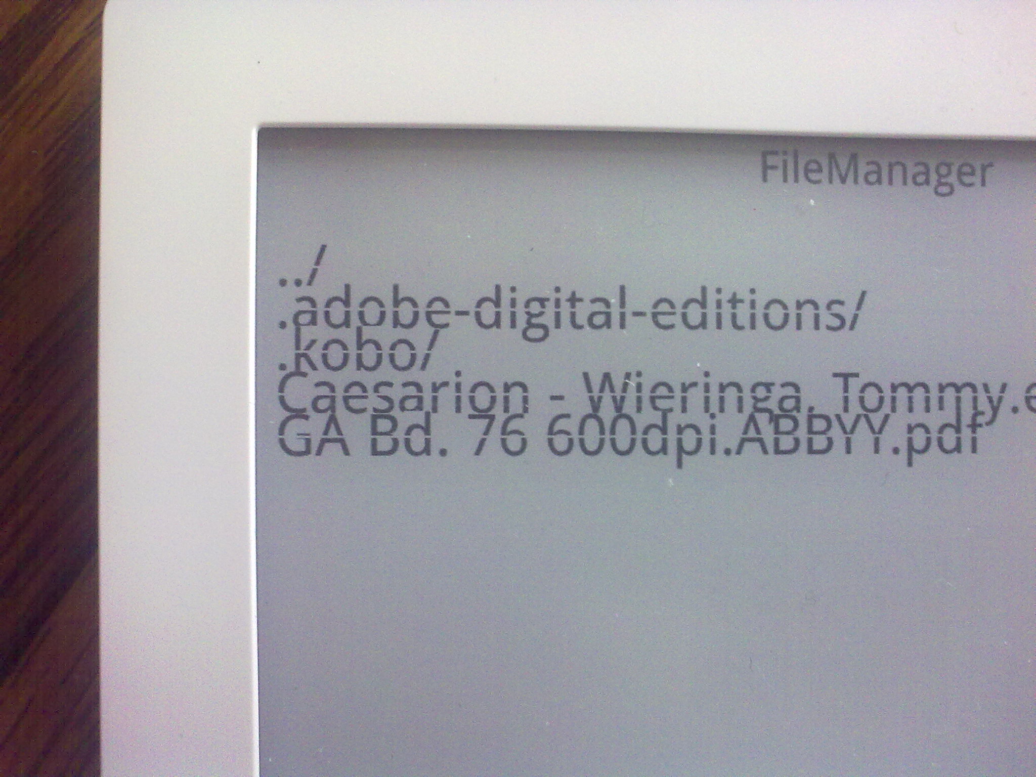

I tried it and it seems indeed more responsive.
Unfortunately I get the typical invisible strikeout font. Do you also have this?
What I did was a factory reset, upgrade to 2.6.1., filemonitor and your koreader folder. The only extra thing was enabling telnet in Nickel. (rcS, inetd.conf and inittab are changed.) If you're not seeing it, what could be the reason? The telnet changes?

Yea I get that also, did not looked what is the reason.
How about inv, is that working ? And whatever else was added etc
I thought it came and went with the DPI setting, the koreader folder may be using the 265 DPI from Giorgio's last port post.

Yes, it does, but because I didn't hear anybody else responding to it, I was wondering whether it was just my Aura. If dpi=235 you can set cfont to 24 or 25 without strike-out. That what I did in the last rar-file.
