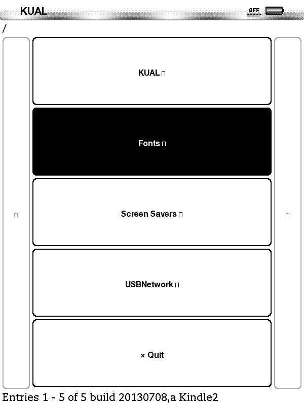

To answer knc1
(Don't mind the broken up/right arrows, that's due to the crappy unicode coverage of my custom Sans font)

To answer knc1
Thanks!
Looks very usable to me.
(At least the pic doesn't say: "SegFault" anywhere. )
That earns the K2 a: "K2: status" field in the (to be) new button blob template.

That did lead me to wonder: do the arrows work on a DX? Because I use the exact same font on my K3, and the arrows work there, but then FW 3.x has a much larger Unicode coverage through the code2000 font (or droidfallback in my case).
I'll try with the default fonts to make sure...
EDIT: Well, crap. No shiny arrows with the default fonts, either. I'll fire up fontforge...
EDIT²: x-ref: https://bitbucket.org/ixtab/kindlela...-graphic-on-k2
EDIT^3: One very dirty workaround later...

Hmm... but that will then crash and burn on a K3. It really will. Even if they're just constant integers, these things are not "inlined" during Java compilation, but they're stored as references to the field names. At runtime, Java will try to look it up, and fail with some funky runtime error on K3's...
Fortunately, for this particular case, there's a simple solution: hard-code the integer value (and explain in a comment what it is).
Since I'm heavily messing around in your branch right now (not because of your code, but because there is a terrible lot of code duplication between KualLabel and KualButton, which I'm refactoring and will be committing when it's ready): can you just post those two constants here please? I'll insert them accordingly.
That said, it may well make sense for *all* devs to switch to the lowest common denominator, maybe a kindlet-*.jar from a K2 (if we are to support that model too). If so, do you mind giving me a hint where I can get one?
