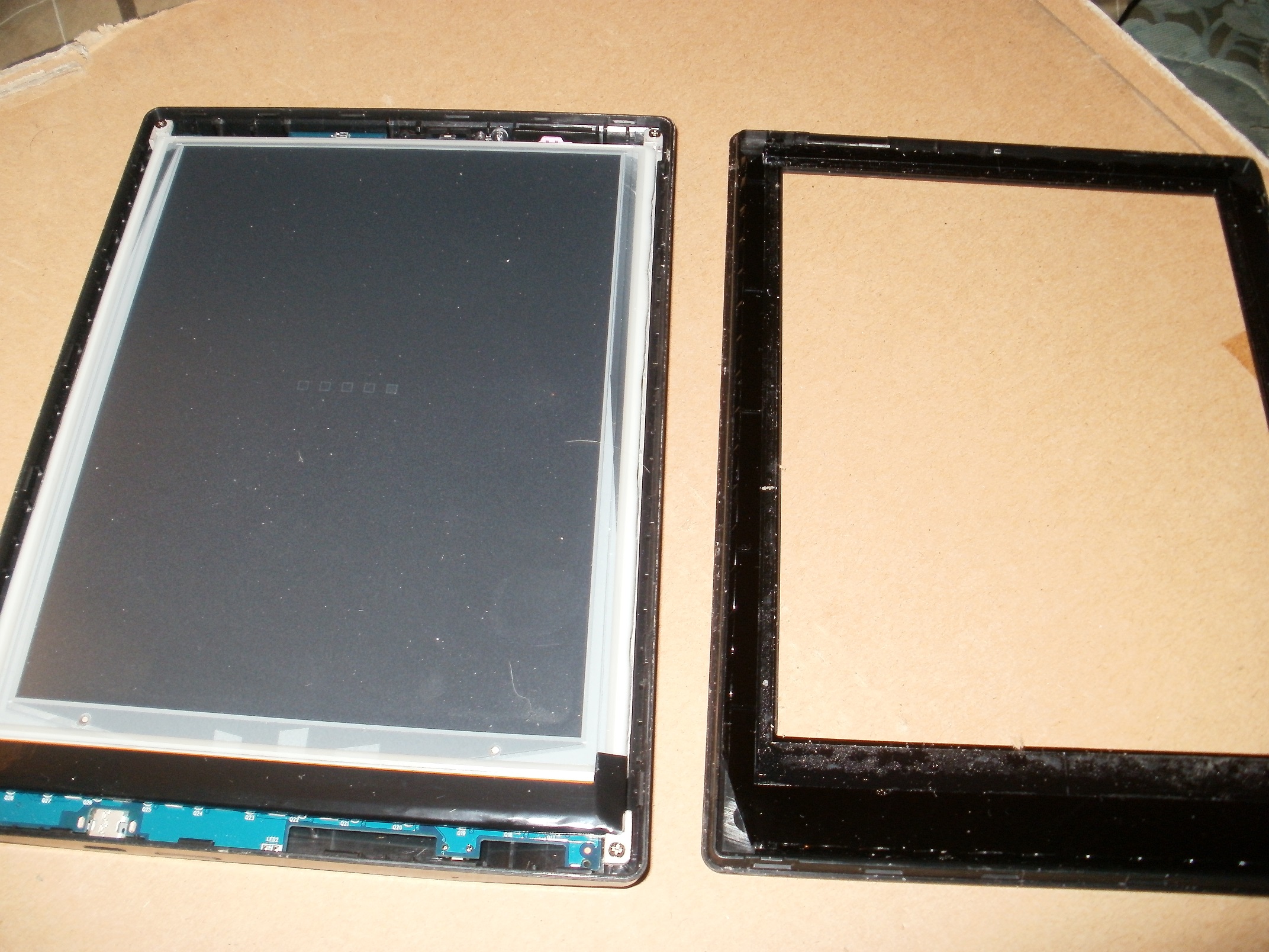

Also, 6 clips at each side, what about the top and the bottom? I mean the ends, not the screen and the back lid. Also 6 clips each?

If you look at the left side of the picture, at full size you can see where the "clips" are. The same for the top. They are spaced pretty evenly. Don't forget the tape.
Luck;
Ken
PS; I just put a 16GB Class4 uSD in my backup AuraHD , no problems with the case.

After opening it up, where can the internal Micro SD slot be found?

You list a "Kobo" a "Mini" and an "AuraHD". It is possible that the "Kobo" is an early model without an internal uSD card. This might help. The componets are on the back side of the electronics and display package.

Thanks for the answers above. I'm asking about the Aura HD - the model referred to in the prefix for this thread. There is a photo linked in msg#17 showing how the Aura HD looks like once it is opened up:
https://www.mobileread.com/forums/att...2&d=1367520084
I cannot see the internal slot anywhere on that photo - must the screen be taken off to reveal the slot? I am not very adventurous, I'd only managed to swap in SD card with larger capacity into my Mini after having seen every step of it being done, so I'm hoping that something similar are available for the Aura HD.

You need to remove the four screws in the corners and remove the insides from the back part of the enclosure and turn it over to get to the components. Just be normally careful taking it out and putting it back.
