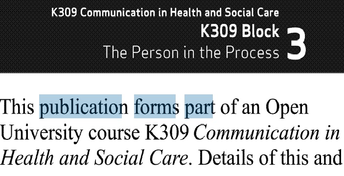

Hi, justification and wrap didn't work It now looks correct but when text is highlighted there are these strange gaps. (see screenshot) Any way to get rid of them?
There's not really a way to get rid of the gaps. They are there because k2pdfopt doesn't use exactly the same font as your document for the internal highlighting, so the aspect ratio of the "invisible" words doesn't exactly match the graphics being displayed, assuming that you used OCR? Or is your output still in native mode?
What do you mean by justification and wrap didn't work? What precise options did you choose? Are you still working on the same sample PDF file that you posted earlier?
