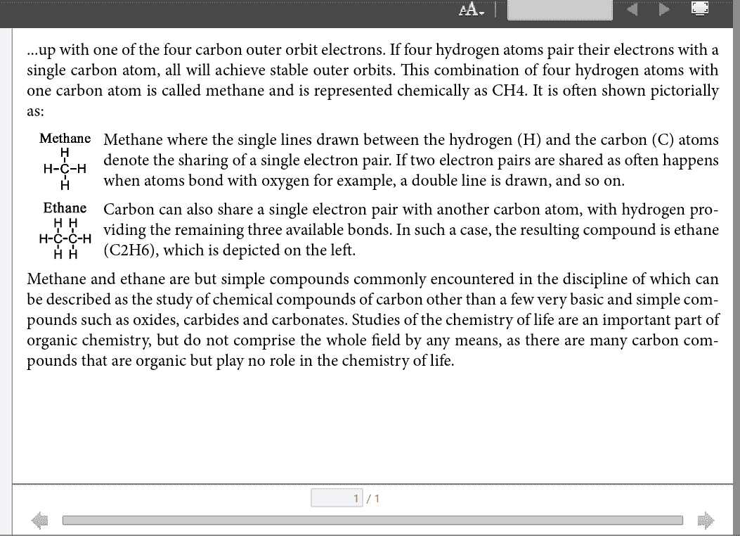

Hi Turtle:
You're right, I had a margin left over from the code's previous iteration.
Getting closer (see jpeg). But the margin is still large. Maybe that's as good as it will get?
Michelle
<div class="FrameSmall">
    <div class="Float-L"><img alt="methane" src="../Images/methane.jpg" width="40%" /></div>
    <p class="First6">where the single lines drawn between the hydrogen (H) and the carbon (C) atoms denote the sharing of a single electron pair. If two electron pairs are shared as often happens when atoms bond with oxygen for example, a double line is drawn, and so on.</p>

Ahhh...you've left width="40%" in your <img> tag...that is taking up 40% of your div container even though the picture is much smaller.
Take it out completely like I did - or - set a max-width:Xpx (where X is the largest number of pixels you want it to take up)...I think those images were about 80px wide IIRC.

Hi Turtle:
I think I see the problem. In your successful case, you made the image smaller and set it to a fixed size; I'm trying to set it to a percentage so it will enlarge with the user's screen. Perhaps, then, what I have is the closest I'll get if I want to keep the percentage option?
Thanks for all your help. You've been wonderful.

Setting the width as a percentage is just telling it what percentage of the container to use. If you set it at 50% then it will take up half of the div...which itself is set to fill the screen with a width of 100%...so effectively you are saying take up half of the screen for this image. Scaling the image in this manner doesn't work for what you want to do.
With an ebook's reflowable nature, the words will automatically fill the extra landscape that a larger display provides...they do NOT automatically increase in font size.
What I think you want is to increase the image when the FONT size is increased to keep the same proportion between the image and font.
You can do that by assigning the width to an "em". If you want the image to be the same height as 3 letters/lines you could say "width:3em" in your CSS. With that method you run the risk that the image would just get distorted/blurry as it was stretched too far, so you can add a maximum pixel width to say "none shall pass" this size. Similarly, you might have an image that is way too small if they are using miniscule font size, so you can add a minimum-width. It's up to you to determine the maximum, minimum and normal size you are comfortable with.
CSS
.image {width:3em; max-width:200px; min-width:50px}
HTML
<div class="Float-L"><img alt="methane" src="../Images/methane.jpg" class="image" /></div>

Yes, I understand it is the width of the container, but the container also changes as the device width changes, so that works. And while the image remains static even as the font size changes, so far at least it is staying attached to the text.
I will try scaling using ems. I didn't realize I could do that with images.

Turtle:
Alas, not working. The image class that specifies an em value for the image isn't being recognized by ADE, so the full size of the image is being displayed. Is that HTML5? ADE doesn't read HTML5 even though some readers will.
And if I try to add the em value div along with the percentage value so the image will scale, the image class is ignored.
(BTW, the p class is important, otherwise the em value for the text is ignored and screwed up in relation to the rest of the book.)

Just realized one error: I made the image class a div class. Fixed that and getting closer but images are now skewed. Will work on it and report back.
Michelle

Okay. We're almost there. I have lowered the margin value of the Float-L division from 15px to 10px and that has gotten rid of the large gap between image and text. The em value is now recognized by ADE (and I also tested in Aldiko, which I have side-loaded on my Fire). Only one small obstacle remains: distortion of the image ratio. I added width=auto into the CSS, and while that works at most image sizes, there is some distortion remaining. Perhaps I suck that one up. But is there a better code than "width=auto".
So now it looks like this and it is working, save for the above notations:
