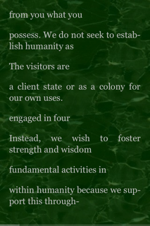

I'm using Stanza on my iphone 4 to read a book called Allies of Humanity, Book One (available for free at this link
<Removed Link>
I used Calibre to convert it to an EPub. When I read it, its okay for a while, but then it starts to mix the paragraphs. I'll get a few paragraphs normal and okay, but then it starts to give a few words of one paragraph, skips a line (blank line), then a few words from another paragraph, then the next few words from the first paragraph. It gets back to normal, then cycles through mixing paragraphs again. I can put up with a lot of inconvenience but I'm wondering if I can fix this problem. I did not see any errors in conversion and there is no info under job details in caligre. I will put a photo of the wacky paragraph fragmenting and alternation.

You just found an extreme case .
Now you see why we say:' Avoid PDF"

If you're running Calibre on Windows you could try MobiCreator to do the conversion
My experience is that Mobicreator often produces 'better results' than Calibre - without experimenting with lots of settings. It creates PRC files, not sure if Stanza can read PRC, but Calibre does a good job on converting PRC to ePUB or one of the other formats that Stanza supports.
I also just stumbled on another converter from Hampster Soft (thanks to member Dullahir). It seems to produce better results than both MobiCreator and Calibre, its simpler to use than Mobicreator, and it can create an EPUB directly.
If you install it the Hampster Soft program watch out for the Open Candy stuff, and make sure you do a custom install - otherwise you'll end up with AVG toolbars in your browsers etc etc <grhhh>

Thanks guys. Yes I did read the problems with pdf's document. I did download and convert using mobicreator, with the exact same outcome. So, I guess I'm not going to be reading that book on an ereader! Luckily I can read it directly from the website (I just discovered today) and not have to deal with it. Or, I could PAY (!!!) and get the official kindle version. I'm so cheap

What size is the file? I strongly suspect hat is an image based PDF with some random text characters underlying it! If so it will never convert properly.

@Janelle12 oops sorry, not only is the 'p' silent, it's absent
Google for Hamster Soft - watch out for hidden extra's - do a custom install.
Oh, it needs .NET 3.5
I just had a look at the website for that book - it looks like its very straightforward text in a single font, I'm surprised mobicreator didn't to a satisfactory job - maybe they 'deliberately' crippled the PDF to make it 'unconvertible'
Silly question - have you tried reading the PDF with Stanza ?
Here's three other tricks you could try.
  1. You could open the PDF in a PDF reader (I use Trackersofts PDF xChange), and print it as a PDF via a PDF print driver (I use the one from Bullzip). Then convert the PDF that print driver created. That's worked for me a couple of times.
  2. A variant on that is to print it to a postscript file see post #6 in this thread https://www.mobileread.com/forums/sho...ght=postscript
  3. If the online version presents itself as not too many pages, you could clip them from your browser into Evernote, export them out of Evernote as HTML, add the HTMLs to Calibre, convert them to ePUB and join them with ePUBMerge plug in. Why Evernote - its clipper is pretty good at sorting the wheat from the chaff.

Yes I ended up reading it on kindle. Stanza conversion would not work. My husband emailed it to the kindle email address and I read it on the actual kindle (second gen) rather than the iphone kindle app.
