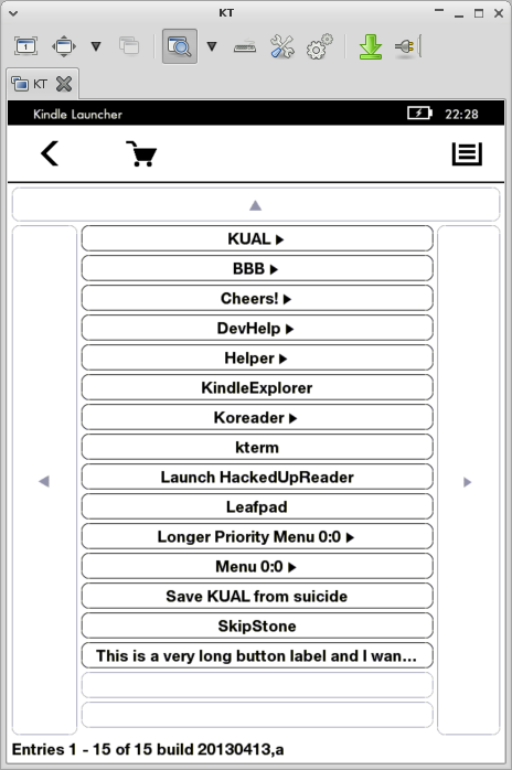

KUAL_show_KUAL_buttons="1 2"
KUAL_show_KUAL_buttons="2 1"
^-- Working to hide kual buttons.
Nice. Order of incidence does not matter. Nor affects button order.
Hides Nicely (picture 1)
However, as shown in picture 1 any value whatsoever (other than commented out no-value default) causes the new logging button to not appear. Unsure if that is by design. "No value" shows all function options.
(picture 2)
I can't reproduce this issue. For me the new logging button appears when
1) KUAL_show_KUAL_buttons=""
2) #KUAL_show_KUAL_buttons="whatever"
note that 1 and 2 are equivalent - they both leave KUAL_show_KUAL_buttons unset, which looks up default value "1 2 3 99" (all currently defined buttons for the KUAL menu)
3) KUAL_show_KUAL_buttons="3" and no other KUAL button shows up
If I enter an invalid value, like KUAL_show_KUAL_buttons="-1" or " " the KUAL menu is not shown at all. You could qualify this as lack of defensive programming or a totally borky setting. I think it's the latter Besides, visibly reporting errors that involve KUAL.cfg is complicated, so I prefer to let some error manifest themselves in their obvious, non-destructive consequences - it's a kind of error reporting.
If I enter a mix of valid/invalid values, like "33 1 2" then the KUAL menu shows buttons 1 and 2. I think it works sensibly, don't you?
In summary: I can't reproduce this issue (with my current dev build).

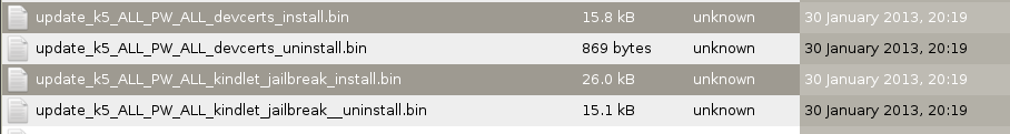

when I copy the file update_k4_ALL_devcerts_install.bin to the root of my kindle, and unplug it from the USB, the file is automatically erased from the memory, and the "Update my kindle" option is greyed out.
Any ideas?
briefer666 is offline   Reply With Quote

You have a kt.
use the right files.
K4 is a KINDLE 4
KT is a KINDLE 5
Old 04-12-2013, 02:22 PM   #714
briefer666
briefer666 began at the beginning.
briefer666's Avatar
Posts: 11
Join Date: Apr 2012
Device: KT
That was it!
thank you!

changed sorting default
Kual 0.5 update. I have reworked the sorting options a bit. So now ABC sorting affects just the top-level menu and leaves the order inside each sub-menu intact as originally set by the menu author. So authors can add some visual impact to their menus

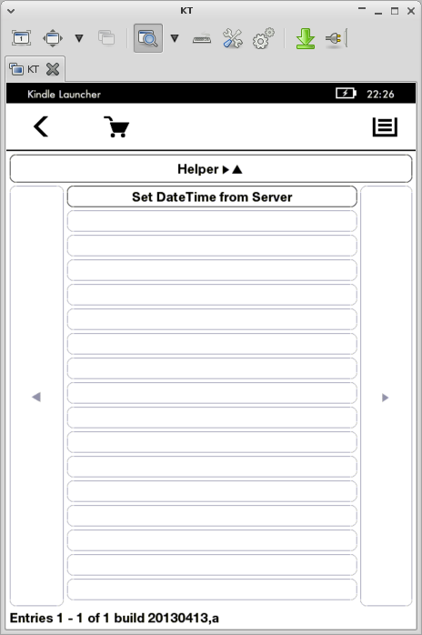

Old 04-12-2013, 08:12 PM   #717
twobob
( ͡° ͜ʖ ͡°){ʇlnɐɟ ƃǝs}Týr
twobob's Avatar
Posts: 6,586
Karma: 6299993
Join Date: Jun 2012
And Cheers to you
I shall resume the testing tomorrow.
See I can break it some more :P
So happy with the new tranche though. next-gen KUAL is on the horizon at last.
One small step for us, One giant Leap for kindle kind.

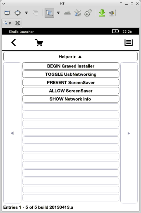

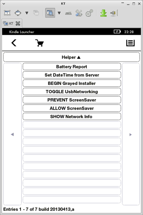

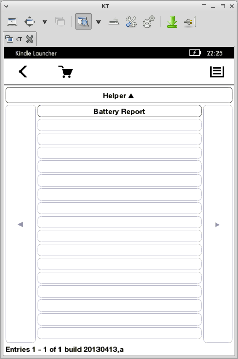

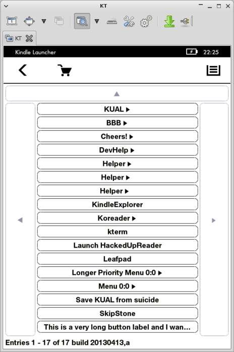

menu collation
I have added automatic collation of same-name menus, see the attached pictures. it can be disabled in KUAL.cfg. I'm undecided whether to keep it as a stable feature or let it go. It works OK, but perhaps it will be too slow on lower devices. Well I don't know now, I will be able to test it when the K3 arrives Enjoy the screenies: pics 1-4 without collation (Helper menus); pics 5-6 with collation enabled.
ID:	104318   Click image for larger version
