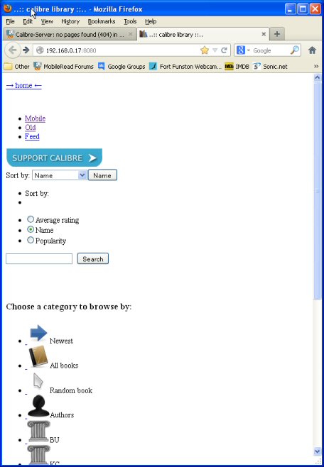

You may have 2 things going on:
The image you see is similar to When I set Firefox to View:Page Style: No Style. Change the setting (while viewing) to Basic Page Style
BTW as you can see: the URL in the address bar works, you may have some other settings in your browser blocking things. Try disabling some of the Browser plugins
