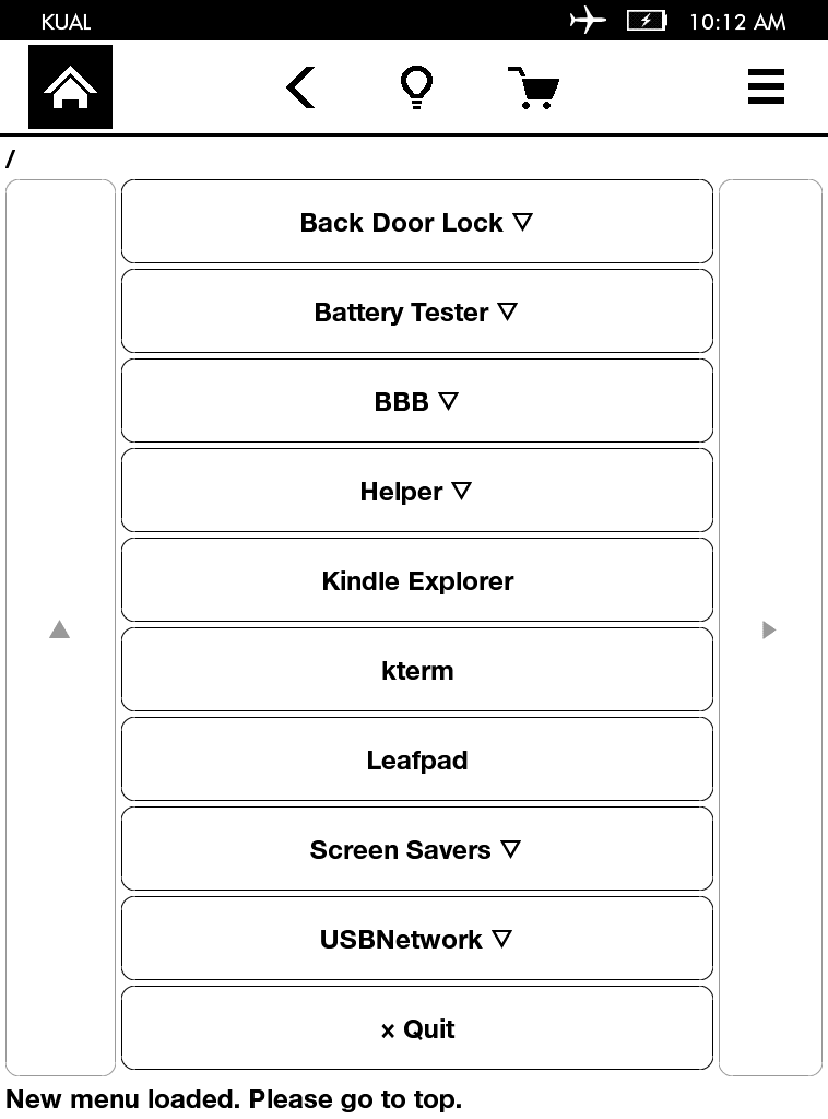

I added the Videos folder to my Paperwhite extensions directory, now a strange thing happens when I run Kindle Launcher. Not only do I NOT get "Videos" added to my list, but the listing for "KUAL" is no longer there. Any ideas? Here are the screenshots taken before and after adding the Videos directory.
ID:	110823   Click image for larger version
nypaulie is offline   Reply With Quote
