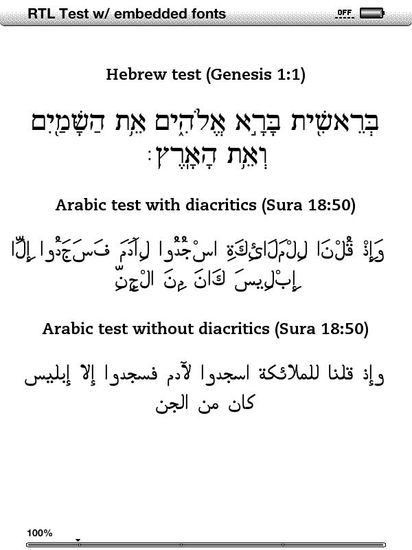

Unfortunately, it isn't as easy as that, because 5 Hebrew letters have different shapes at the end of a word and as tomsem has pointed out, you wouldn't be able to mix RTL text with LTR text.
However, all of this isn't really necessary, because all current Kindles (K3 and higher) support RTL text (some older Kindle apps don't).
@fredsmith123:
If you use Calibre to generate Kindle files, select AZW3 and not MOBI as the target format. You can also simply open your source file with Kindle Previewer, which will automatically generate a master mobi file.
Some time ago, I created an Arabic/Hebrew font embedding test file that you can use to test whether your Kindle supports KF8/AZW3. (The source code is embedded.)
Hi. I am experimenting with the arabic language for .mobi files and I was wondering how you were able to generate the attachment above. The mobi file you provided renders correctly on my PW 5.3.4, but I was unable to reproduce it.
I tried converting using Calibre to epub then to mobi but the result was rendered incorrectly.
I also tried the unpack tool but it failed.
chaditrad is offline   Reply With Quote

It's not a Mobi file; it's a KF8 file.
Actually, it's both.
I used KindleGen 2.8, which creates a master .mobi file that contains both a regular .mobi file and an .azw3 file. (KindleGen also attaches the source files, which can be extracted with 7Zip or Keka.)
But you are of course right. The OP needs to convert to AZW3 not MOBI.
I did some experiments and found out that eInk Kindles actually support Arabic vowel signs, if you keep the styles simple.
(Unfortunately, you cannot embed Arabic fonts.)
@chaditrad: To automatically generate a master .mobi file, download Kindle Previewer and open your .epub or .html files with it. Kindle Previewer will automatically generate a .mobi file.

... I did some experiments and found out that eInk Kindles actually support Arabic vowel signs, if you keep the styles simple.
(Unfortunately, you cannot embed Arabic fonts.)...
I'm a bit confused. Didn't you embed the fonts in post#5 attachment?.
Old 03-29-2013, 03:25 AM   #12
Doitsu
Doitsu's Avatar
Posts: 5,795
Karma: 24088595
Device: Kindle PW2
I did. But for some odd reason, Kindles don't use the Arabic glyphs, when you embed Arabic fonts. (If you mix Latin and Arabic text, the Latin glyphs actually show up.)
That's why I didn't embed fonts in my latest test file.
Also since I figured out that Arabic vowel signs are supported up to a certain font size I created a new test file without embedded fonts.
