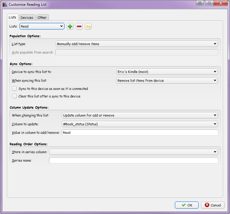

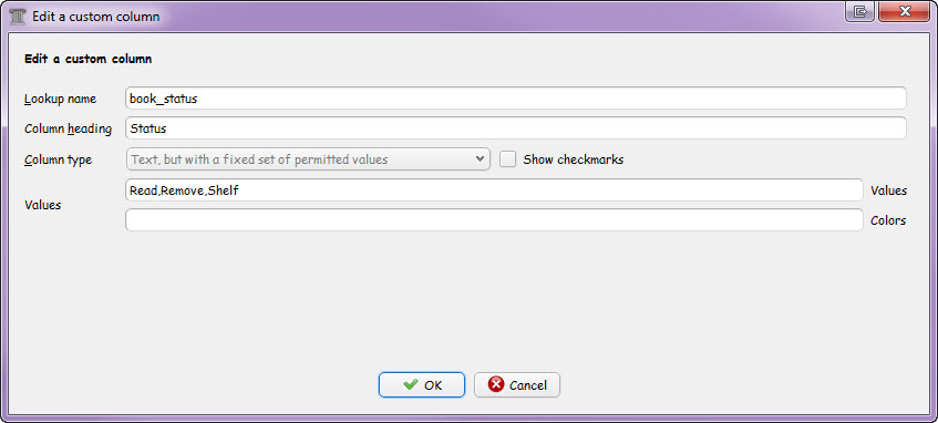

Reading List setup to manage reader content and Read
Answering @Firedancer885 made me realize it may be helpful to new users of calibre and the Reading List plug-in if I gave more details on how I have my Reading Lists setup. I have inserted screen shots of my customer column and Reading List setups at the bottom of this posting. I hope this helps.
I have a fairly large collection of ebooks, so I needed a way of managing which books are on my Reader (Kindle) at any given time. I try to keep the number to around 50 at a time (just my own preference, this does not effect the setup/functionality). I also wanted to track which books I have already read.
I have set up a custom column to track the Reading List to which my book is currently assigned called book_status, since for me the purpose of my Reading Lists are to track the reading status of my eBooks. The name can be changed to something more appropriate to your needs, you will just need to refer to your fields name when setting up your lists. My Reading Lists are setup so my books can only be in one list at a time. If this is not preferable for your situation, you can define the custom column as a 'Tag like' text column instead.
I have three Reading Lists setup:
Shelf: These are the eBooks I currently have on my Reader. Adding a book to this list will queue it to be added to my Reader the next time I do a Reading List sync.
Read: These are the eBooks I have read. Adding a book to this list will queue it to be removed from my Reader the next time I do a Reading List sync.
Remove: These are eBooks I have not read, but wish to remove from my Reader. Adding a book to this list will queue it to be removed from my Reader the next time I do a Reading List sync. This list will be cleared after the sync.

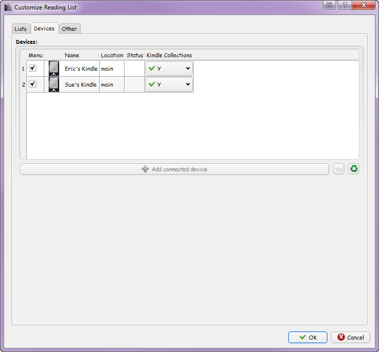

Re-add Reader/device to Reading List
Originally Posted by Kraftwerk View Post
It looks like I have to sync it: Could 'edwdecarlo' or someone show me step by step how to do this.
Important Note: @kiwidude has setup the Reading Lists to be device independent, so adding or removing devices will not affect the content of a Reading List.
Here are the steps to remove a device and re-add it to the Reading List Devices:
  1. Do not have any Reading device connected to your laptop/PC/etc
  2. Start calibre
  3. Open Customize Reading List setup (use whatever method you currently use)
  4. Select the Devices tab
  5. Select the device to remove and click Delete (Recycle button at bottom of the list). Answer Yes to confirmation.
  6. Click OK to exit Customize Reading List
  7. Restart calibre
  8. Connect reader/device. Wait for calibre to recognize the device (you'll a connected message at the bottom of calibre window, next to the version information)
  9. Open Customize Reading List setup
  10. Select the Devices tab
  11. Click Add connected device (below devices list). This should automatically add your connected device to the devices list
  12. Click OK to exit Customize Reading List
  13. Restart calibre
You should now be able sync your books to your device via Reading List.
If you have any device specific Reading Lists which use the device you just re-added, you will need to reset the 'Device to sync this list to:' value for those Reading Lists.
edwdecarlo is offline   Reply With Quote
