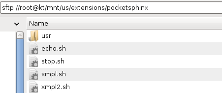

I'm all excited to try this but in my case I get a "Could not find Mic element" (see the warning at the end of the spoiler):
[root@kindle bin]# ./pocketsphinx_continuous

INFO: continuous.c(371): ./pocketsphinx_continuous COMPILED ON: Mar 24 2013, AT:
03:41:36
Warning: Could not find Mic element
READY....

You would run the old one like:
/mnt/us/extensions/pocketsphinx/usr/local/bin/pocketsphinx_continuous -logfn /dev/null
that gives less spurious/verbose output..
EDIT: OKAY I ATTACHED MY CURRENT DEVELOPMENT FILES BELOW...
ONE THING THOUGH... the attachment below... the MADE BY ME scripts don't work yet... (pictured) so dont bother running them yet...
Im only adding here for you to rip what you want out of it...
The newly attached stuff here runs on all devices and has most of the warnings patched out.
You would run this one like...
/mnt/us/extensions/pocketsphinx/usr/local/bin/pocketsphinx_continuous -logfn /dev/null -lm /mnt/us/extensions/pocketsphinx/usr/local/share/pocketsphinx/model/gui/gui.lm -dict /mnt/us/extensions/pocketsphinx/usr/local/share/pocketsphinx/model/gui/gui.dic | cut -c 12-
It only recognises the words in THIS list

Go HERE: http://www.speech.cs.cmu.edu/tools/lmtool-new.html to build your own word list...
