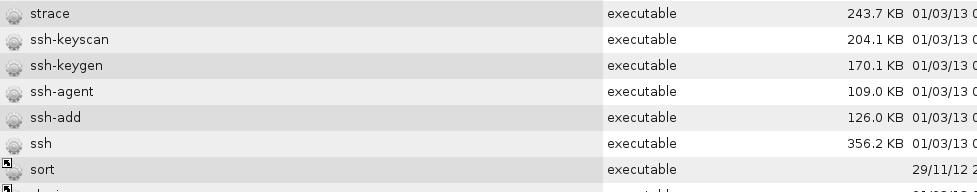

Okay I looked in buildroot.
It is indeed there...
I'm having a REALLY quick go with a stupidly old Toolchain.. : ) just for extra compliance. (should run on all devices if I get it done)
ongoing...
EDIT: Okay I built it...
Will figure out how to export it tomorrow. or you can dig it out yourself from this lot... I THINK I bundled the right stuff... hey its 5am... : )
Enjoy
EDIT: ADDED THE ELUSIVE LIBXFONTS.so.1 that enables Xephyr to "work"
File Type: zip HAD-TO-ZIP-TO-GET-ROUND-FORUM-FILESIZE.zip (16.58 MB, 382 views)

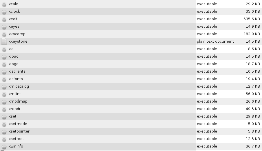

EDIT: attached a few basic xapps like you asked for.
I am presuming you have the support libs where required.
