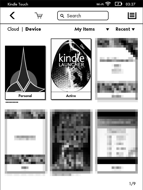

LOL... not sure how I managed it.. but... when I downloaded the klingon.mobi I must have had two copies...
so it became:
/home/me/Downloads/Klingon (2).mobi
I threw it onto the KINDLE TOUCH device via SSH AND IT REBOOTED!!! HAHAHAH! perhaps it was the mangled name ??
anyways. no harm done. seems to be fine now. just thought I would share.
(oh the image looks a bit small on the touch) [picture 1]
looks really nice on the 3 [picture 2]
Great work.
