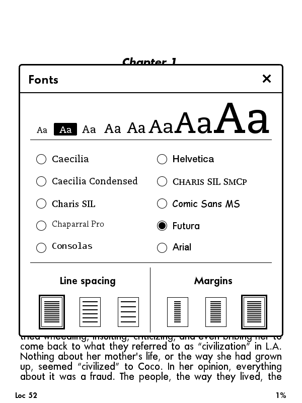

Here is the extra fonts you need for KT 5.3.2:
HeiseiMaruGoth_JIS0213_E
HangulGothicMTC-Medium_E
MHeiGB18030C-Medium_E
MHeiC-Medium-Big5HKSCS_E
Added it to my fonts.txt on my Touch, and it hides the fonts like seen on the attached SC. For convenience my fonts.txt is attached as well.

Thanks for that. I downloaded the 5.3.2 update and discovered those but wasn't sure of the actual family names used. Sure enough, those are the names defined in 48-lab126-local.conf. They must look great displayed in the Aa menu.
Added and updated. Thanks again.

Sure, but I don't trust the config files. I got the list out of the running fontconfig with fc-match -s. That are the real names it ends up beeing.
On the Touch you cannot even read them - they got ... at the end.

Sure, but I don't trust the config files. I got the list out of the running fontconfig with fc-list. That are the real names it ends up beeing.
I didn't trust them; I was waiting for you to comfirm it. Really appreciate that.
They really went out of their way to simplify the names. Of course, they were probably never intended to be displayed there.
