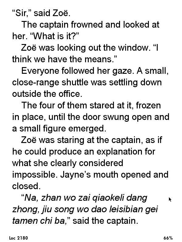

ID:	103782   Click image for larger version

Edit: I saw this picture online and these are exactly the fonts that automatically appeared on my Kindle.
