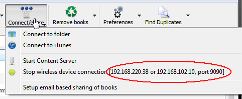

My computer has more than one IP address. Which one do I use?
If you see more than one IP address listed in calibre after you start the wireless device driver (see "The app won’t connect to calibre. What do I do?" above), then it is highly likely that only one of the IP addresses will work in Calibre Companion. The following image shows two IP addresses.
You need to pick the IP address that your computer uses to talk to the wireless network. You can find the correct IP address to use with the help of Calibre Companion by clicking on the “Calibre’s IP address” menu item.

CC connects but then sits there doing nothing. What do I do?
Calibre Companion connects to calibre as a "device", which means that calibre is in charge. After Calibre Companion connects, you use calibre to send books to your device and delete books from your device, just as if your device were connected using a cable.
After connecting, go to your computer running calibre, select some books, then click on the "Send to device" button.
