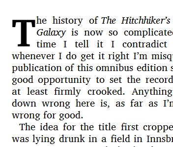

Hello everyone. I converted a number of books from epub to azw3 after upgrading my kindle keyboard to the new version that reads the K8 format. However, I noticed that there were some formatting problems. I read in other posts that the epub to azw3 conversion should yield good results, so I am wondering if there is something wrong with my settings.
I tweak the epub first using sigil, making very minor changes such as 5pt left and right margins, et cetera. Then I save and convert to azw3 using Calibre. My settings are, for Look and Feel:
-- Disable font size rescaling unchecked
-- Minimum line height 120%
-- Line size: .5em
(I did not fool around with these too much since I am not sure what to do -- forgive my being a noob)
For structure detection, everything is turned off. That is basically it. Everything else is, I guess, at default and/or turned off. Is there something wrong with these settings?
The formatting problems I noticed are as follows:
1. On my kindle, the line spacing of AZW3 is much larger than with the old mobi files, so that I have to keep switching between medium and large line spacing when switching between mobi and azw3 books. Is this normal? The line spacing problem does not show when I view the azw3 format using Calibre's viewer. It only shows when the books are in my kindle. All the AZW3 books I converted have really large line spaces.
2. The dropcaps do not convert properly. I have attached screenshots of this. The first one is the epub, with a much larger dropcap letter. The second is the AZW3, where the letter becomes much smaller.
I am sorry if these are noob questions but I would really appreciate some help on the proper settings to use for converting epub to azw3. Thanks in advance.

Here is a suggestion. Use Kindlegen to convert the ePub. Then if the drop cap looks better, use Tweak Book in Calibre to have a look at the CSS code and then you can replace the code in the Calibre made AZW3 for the drop cap. But just remember, that changing the line spacing an through off the code for the drop cap as it wasn't designed for a larger line space.

There is NO magic setting. Dropcaps render differently (or not at all) on different devices.
Personally, I Edit the EPUB stylesheet, convert and see what I get.
(repeat) until it is close.
Simplest is to lose (edit out the code) the Dropcaps
