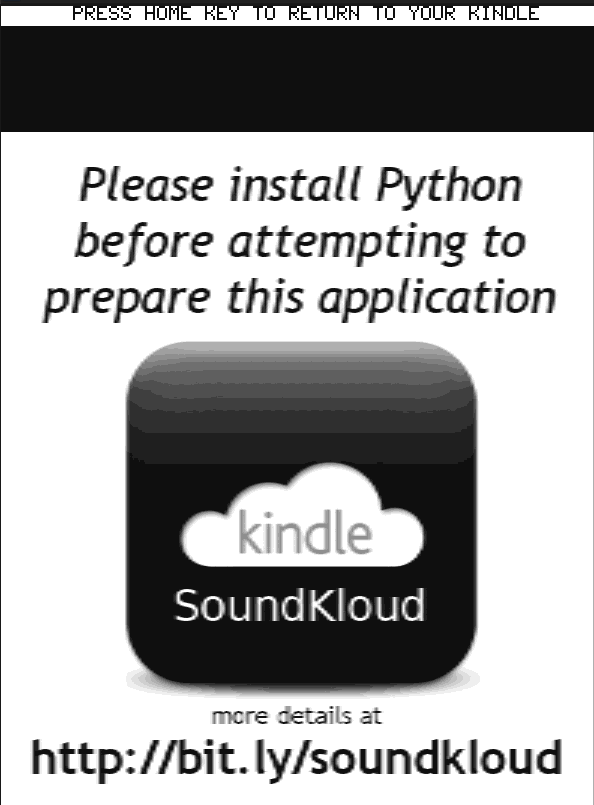

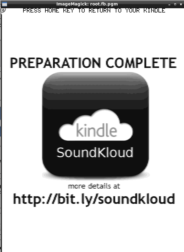

Todays work. replaced all the headachey python module install details with a shell script.
[root@kindle root]# /mnt/us/soundkloud/prep.sh

EDIT: Updated version will try to check for non-standard installs...
(this is on a 5 with a non standard installed python but a missing pythonenv for example)
[root@kindle soundkloud]# ./prep.sh
Internet Connection tests as okay... Continuing
Non-Standard Python install maybe?... Searching /mnt/us/* (gimme a sec...)
python located, run AND greater than version 2.7: 1
Sorry it didn't work out... For more info on WHICH PYTHON TO RUN see http://bit.ly/soundkloud
okay so let see what would happen if we "fixed it"
(NOTE: the pythonenv files EXPECTS to be in a directory named python to minimise false postives, and in the /mnt/us/* hierarchy)
So where are we gonna do this test?
[root@kindle python]# pwd
/mnt/us/usr/share/python
[root@kindle python]# cat > ./pythonenv << EOF
> export PYTHONPATH=/mnt/us/usr/lib/python2.7
> EOF
Now it works okay... Even with a non-standard location. ( fails on zero size files)
To hide library complaints one could....
[root@kindle soundkloud]# ./prep.sh 2> /dev/null
prep.sh

this makes a one shot installer a far closer reality.
Also fixed up the build scripts to be much shorter and simpler to read.
reworked the build so that the armv6l and the arm7l targets are chosen at run-time. Thus one release suits all..
more stuff i should note down but yeah progress.
ID:	98943   Click image for larger version
Name:	ImageMagick: root.fb.pgm_101.png
Last edited by twobob; 01-13-2013 at 11:53 PM. Reason: updated prep.sh, added a bunch of error handling, fixed dirname call issue.

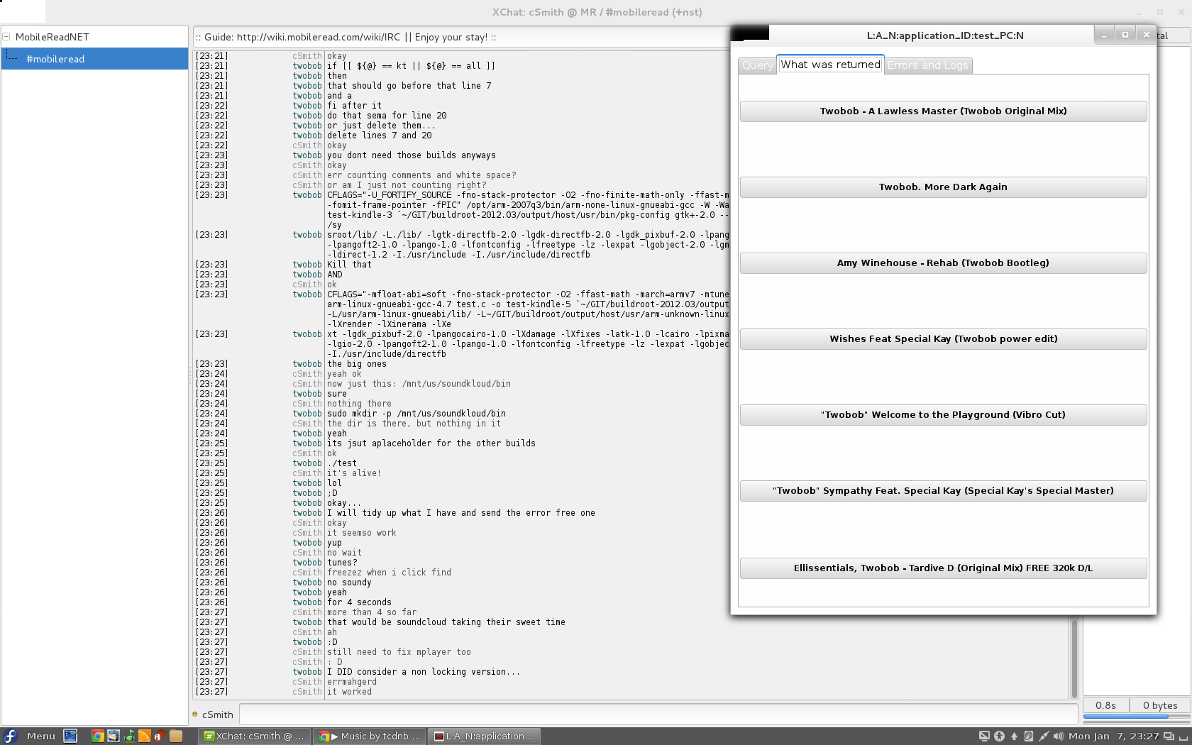

A present for the masses:
qlob is offline   Reply With Quote
consider a non-locking version. classic
