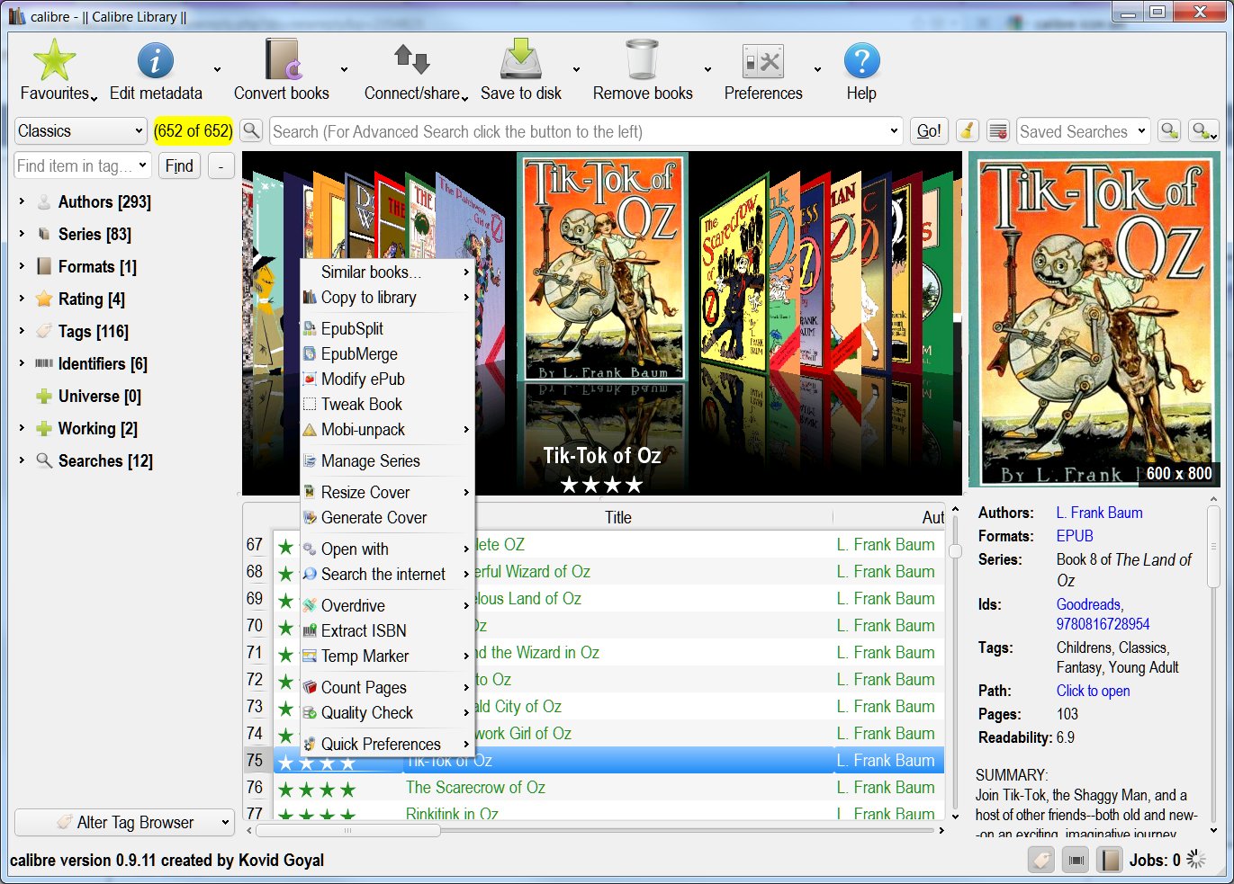

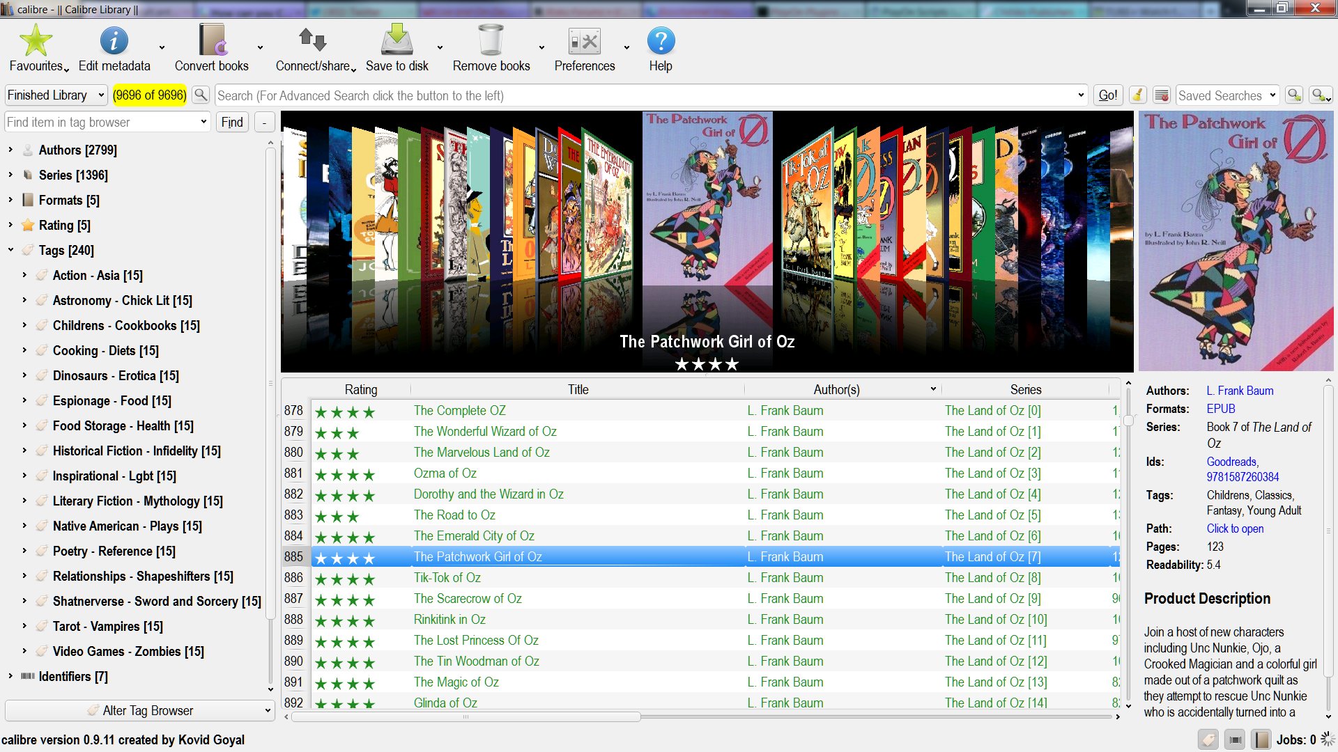

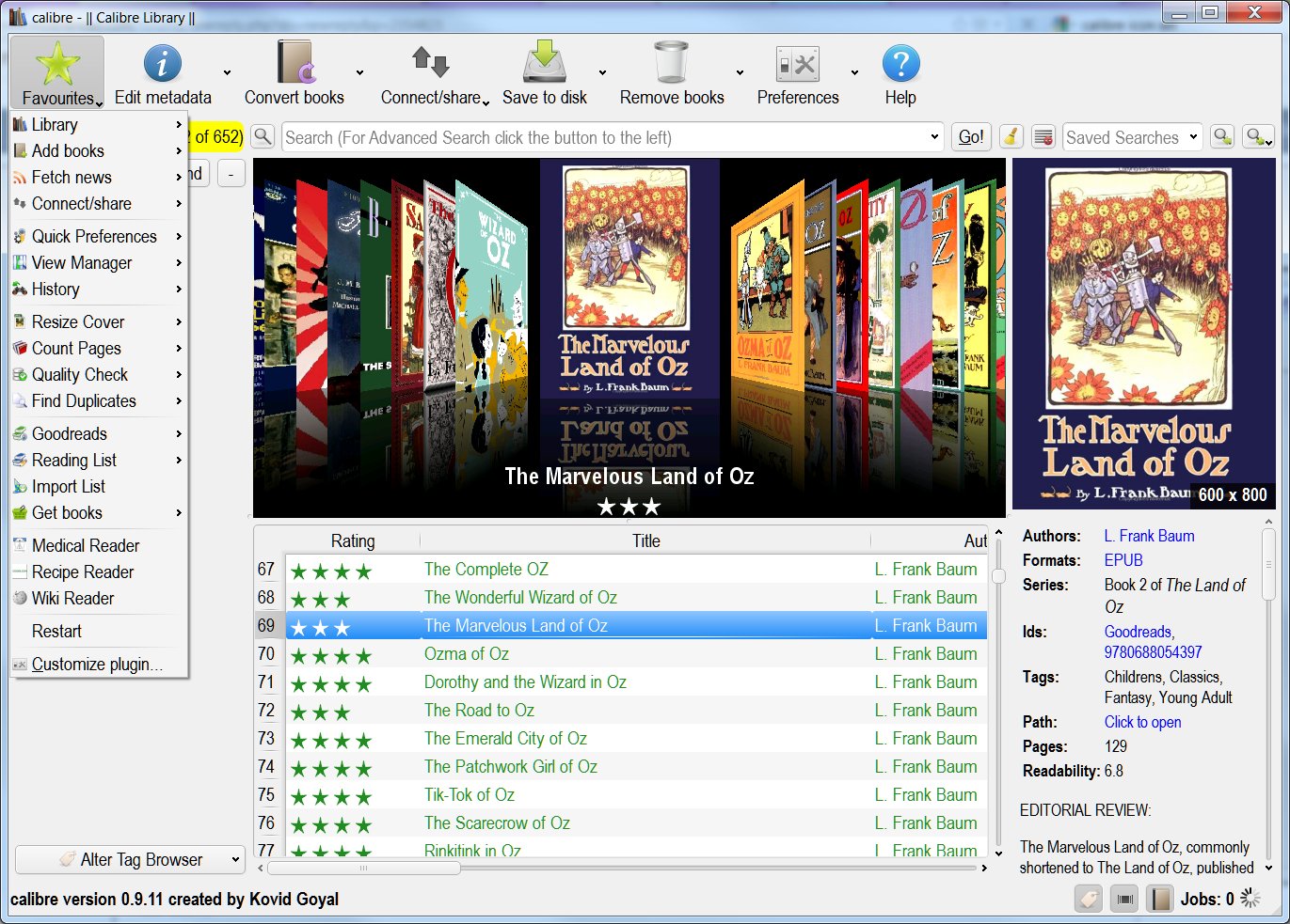

Yes I changed the icons that are used by calibre. I also customized my toolbars and menus to get them to where I like them. You'll notice that I also use the Favourites plugin by Kiwidude, customized to my liking. Kovid has given us a great deal of flexibility to tweak things to our tastes.
Originally Posted by chilady1 View Post
I am on version 0.9.11 so it is the latest version of Calibre but noticed that your icons look so much better. Help? Thanks!
You can change the icons that are used by calibre as well as what icons are shown by what toolbar. I posted about some available icon sets for calibre here.
Update: Also as of this version you can easily change all columns in your book list to one color with a basic rule. I'm experimenting with green. I had changed the Rating column (stars) to green a while back. You can set the rules by going to Preferences - Look and Feel - Column coloring tab. Other tabs under look and feel alter the interface too.
ID:	98177   Click image for larger version
ID:	98178   Click image for larger version
ID:	98180   Click image for larger version

Partitioning in the tag browser and subgroups using the hierarchy feature are two different things.
Partitioning is set via Preferences - Interface - Look and Feel - Tag Browser Tab. Setting up subgroups using the hierarchy feature is explained in the link PeterT provided above.
@chaley The reason I showed the tags expanded in the third image I attached above was so folks could see the possibilities. Thanks for building this feature.
