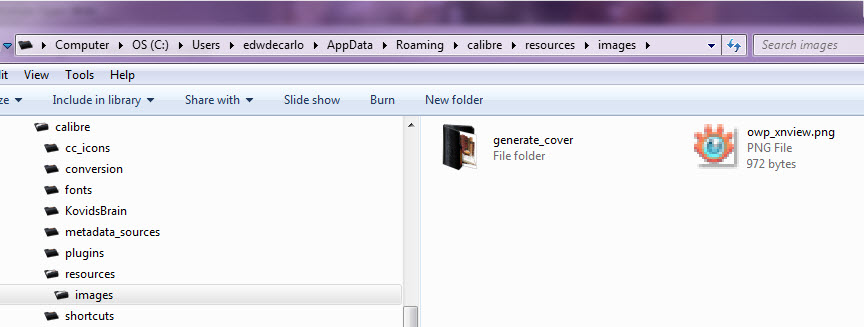

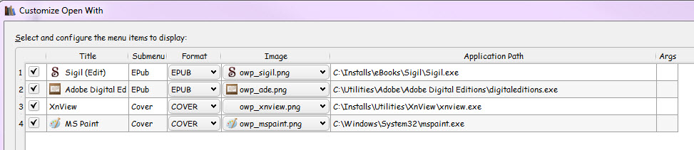

Not Showing Image/Icon when New Image Added (cosmetic only)
Discovered something which does not effect functionality. This is just cosmetic, so not a big deal.
Running:
Win 7 (64-bit) - Fully up-to-date
Calibre v0.9.27
Open With v1.5.7
I have set up a Covers Open With for XnView. I am able to have the cover Open in XnView without any issues.
What I have noticed is that the Image/Icon I uploaded for this option does not appear where the images/icons do for the apps which have built in support (Sigil, Paint, ADE, etc). This includes on the Open With config screen and the Open With menu items.
When I do the 'Add New Image...', it does get copied to the Calibre [User]\AppData\Roaming\calibre\resources\images directory.
I have included screen shots of my Open With config and [User]\AppData\Roaming\calibre\resources\images dir. Note: the image I uploaded is 16 x 16.
Thanks.

You need to remove owp_ from the filename, just use xnview by itself.
Not sure why it conflicts but i had the same problem, that fixes it
Aleyst is offline   Reply With Quote
Old 04-19-2013, 11:03 PM   #178
edwdecarlo
edwdecarlo began at the beginning.
Posts: 37
Karma: 41
Location: North Kingstown, RI, USA
Device: Kindle DX,Nexus 10,Fire HD
That did it.
