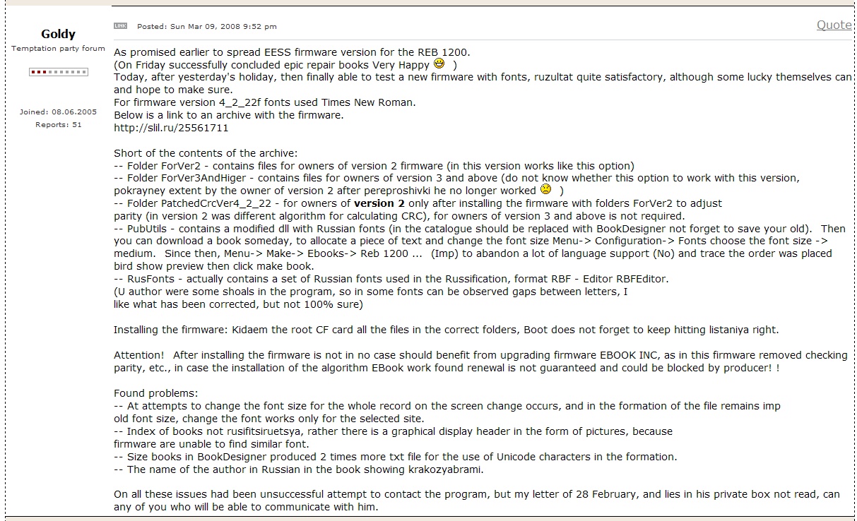

However, the russian site ebook.org does have a post about russia'fying the fonts in the REB1200 firmware by Goldy dated March 9, 2008. I have a copy that firmware, but it is of no use to me as I don't speak/understand russian! I love my REB1200 just the way it is, thank-you!
The attached image shows the english translation of Goldy's post.
There was a program to dump the ROM/firmware on REB1200's that were on version 3.3 or earlier called "reb12dump.zip"; however, it no longer works on recent (v4.x) firmware versions.
