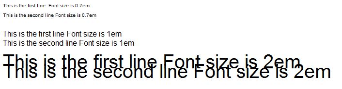

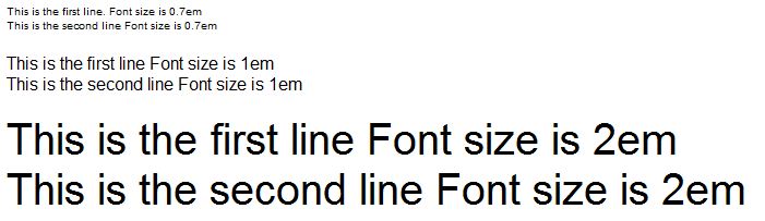

Originally Posted by ShellShock View Post
Regarding the line-height I think the following is happening: my epubs have a line-height set only in the body class. On my Sony PRS-650 this line-height would be cascaded down properly to individual paragraphs, but on the Glo it is not, but is overriden by the line spacing option in the Glo's font options. For some reason the line spacing minimum value seems to be greater than 1.0em, more line 1.5em, so that is a problem - the minimum values needs to go lower.
Kobos line height seems not to be related to font size like on other readers. Looks like kobo uses an absolute line height and this causes problems if small or big font sizes are used. If font size is smaller than 1em you get to much line spacing. If font size is bigger than 1.5em you get almost no line spacing. If font size is bigger than 2em lines go into each other.
ID:	95903   Click image for larger version
