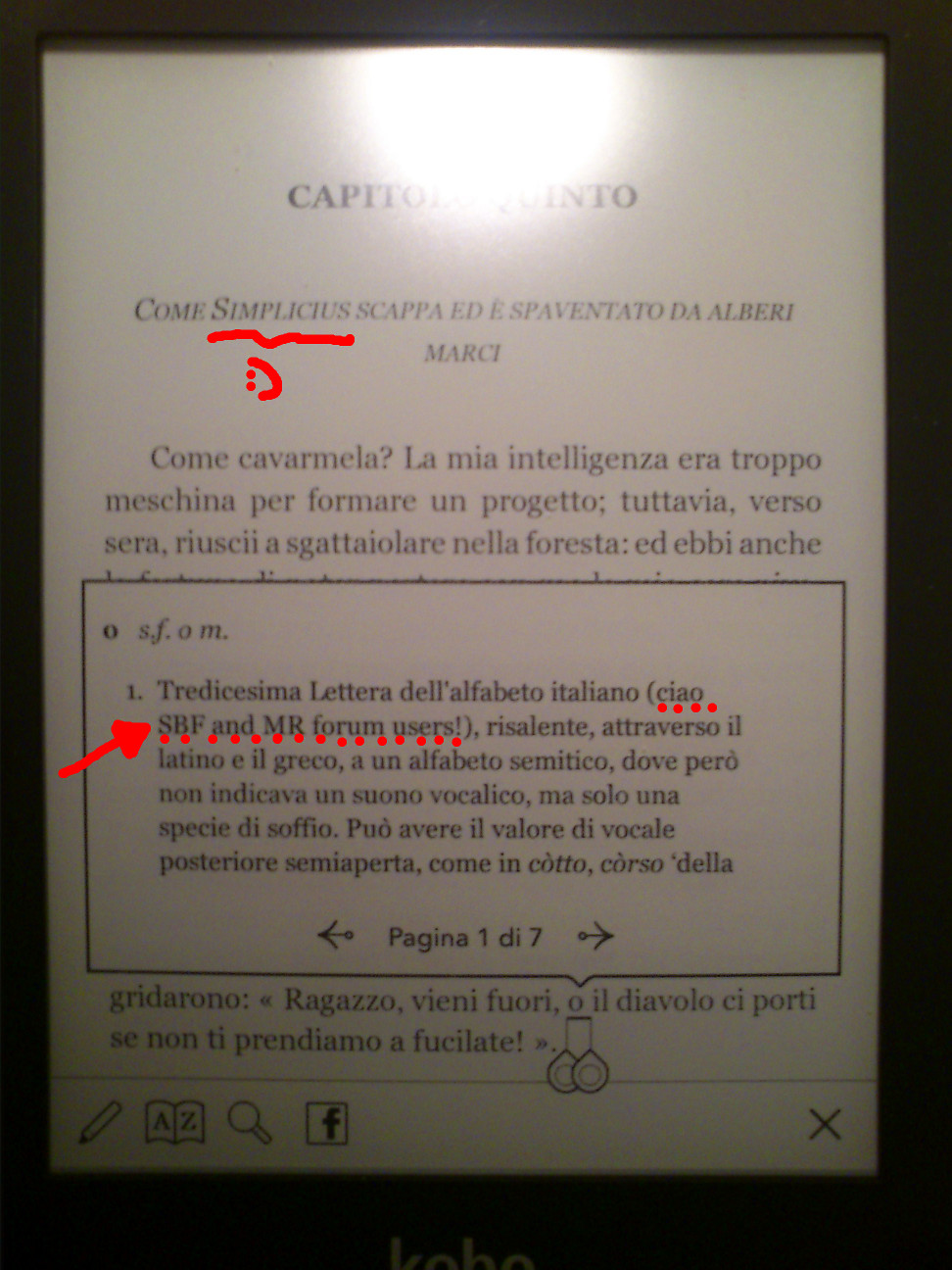

Here you go.
I found out strange things in the process, I will elaborate on them after a couple of additional tests.
BTW, it is important that you compress the files as follows:
$ zip dicthtml-XX.zip *html words
and NOT
because it seems important that words is added as the last file to the ZIP.
It also seems irrelevant whether the "Size" field in the "Dictionary" table of KoboReader.sqlite matches the actual size of your file or not. Similarily, the "LastUpdate" field seems to be ignored. (I guess they use it only for update purposes).

Originally Posted by ShellShock View Post
Ah I see...well it half worked! I don't think my index is working, because it seems to still be using the index of the original dictionary, but when I look up Aardvark, I get my definition, and not the original.
Thinks....but I see I need to switch dictionaries for the new index to kick in...
Yeah, that was what I warned about:
(You might want to change the dictionary to another one and then back to the newly created, so that the index "words" is reloaded.)
AlPe is offline   Reply With Quote
