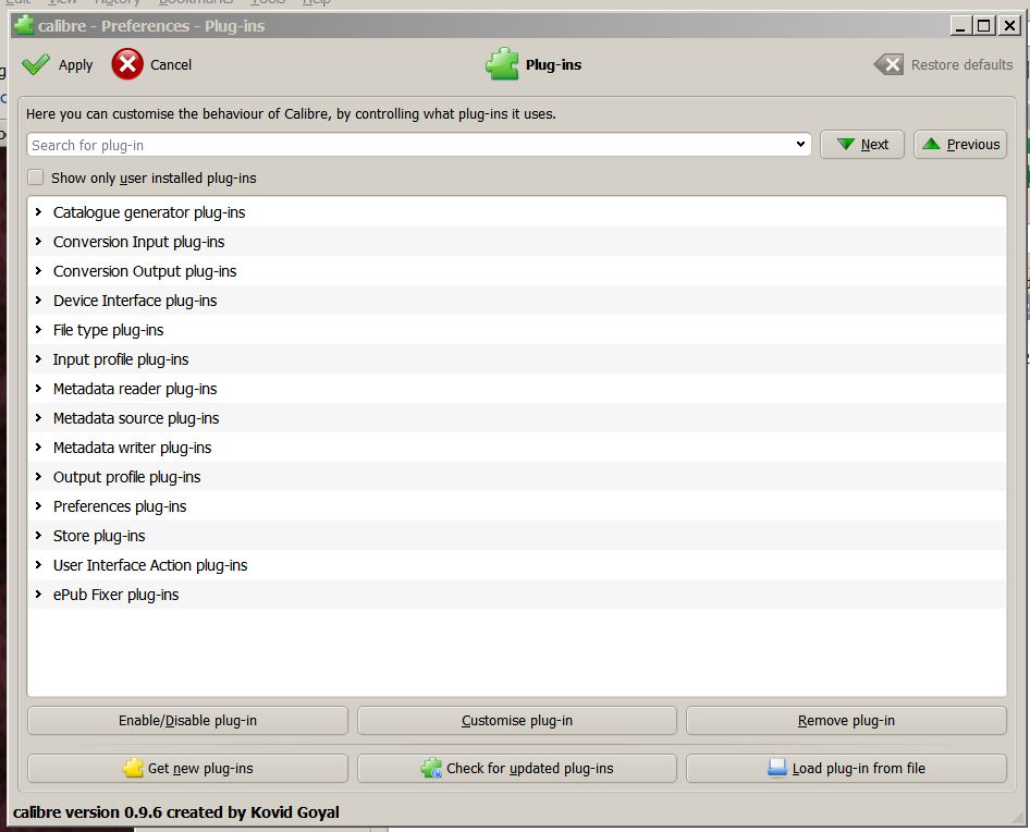

Hi Peter & Helen
OK, I'm one step further, thanks to you, but here are the choices when I get to the plug-ins (see screen capture)
Sorry, you must be getting real fed up with my stupidity!
Hazel x

So now double click the line "Device Interface Plugins" or single click the arrow besides it. This will expand that area and show all the Device Interface Plugins.
Scroll through it and find the line KoboTouch, highlight it and then select Customize plugin and make any required changes.
