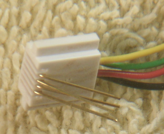

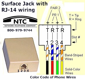

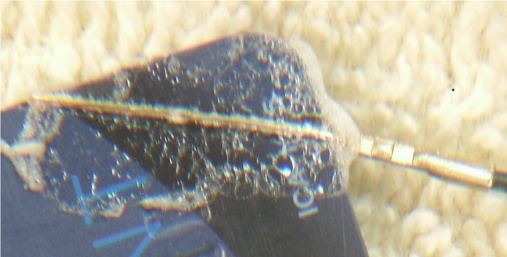

First cut
As I mentioned in the top post of this thread, I wanted to do my K3-J14 connector in a different manner than that done in the original connector thread (link in top post).
The original connector thread used a subtractive process. Where the connector contacts where etched from a copper plated board using the "toner transfer" method.
Nothing at all "wrong" with that process, if you have or can get the materials.
This connector thread uses an additive process. Here the connector contacts are made of gold plated, spring wire laid into grooves in a plastic substrate.
Of course, one of the main questions here is, is this even possible with the materials and tools a person is likely to find around their home (or workshop or local store, or ...).
This work is on the small side of most "construction" projects.
The reader should refer to the dimensioned sketches of the internal dimension of J-14 in prior posts of this thread for the details.
The raw materials will be:
  • A RJ-14 telephone jack
  • A credit card
  • An adhesive
The telephone jack gets disassembled for its four, gold plated, spring wires with attached lead wires. We only need three, the fourth one is a "construction spare".
The credit card is "sacrificed" to provide the slip of plastic for the substrate, trimmed from one side of the credit card. If you cut up the credit card charging you the highest annual rate, you might even make a profit from building this connector tab.
Credit cards are made from a plastic stock that is 0.030 inches thick.
The wires from the telephone jack are 0.015 inches in diameter.
The total height of the connector slot is 0.046 inches.
Duh...
Plus, the little wires need to be held in position, so . . . .
Cut three parallel grooves in the credit card, 0.010 deep, fasten wires into grooves;
both problems solved with an over-all thickness of 0.035 inches.
So these images show the "First Cut" and test of the assembly process.
Now, the only tricky part is cutting the three parallel grooves, 0.010 inches deep, 0.060 inches apart.

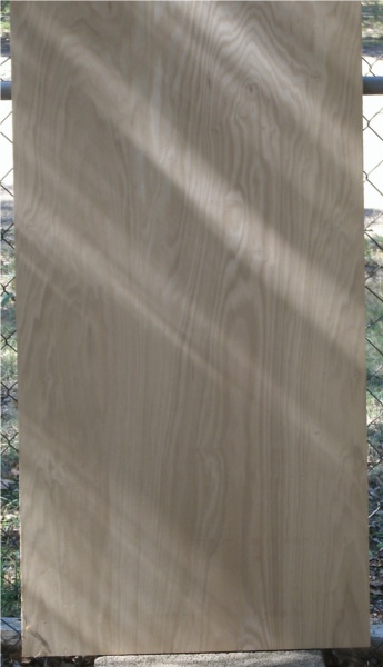

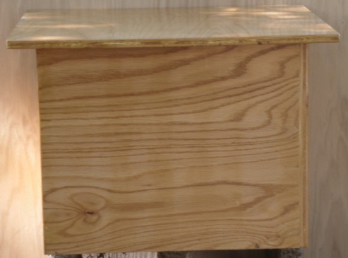

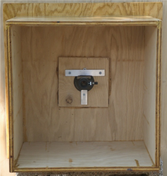

Engraving stand
The grooves needed in the substrate are hardly more than deep scratches. And less than a 1/16 inch apart.
A real challenge for old eyes and shaky hands.
Ah, but mankind is known as a; "toolmaker" (among other things).
Make something to help.
Imagine a router table, with router and router bit -
Only scale it down for the job at hand -
Make it quick, an 8-month old project thread doesn't need anymore delays.
Instead of a router and router bit, plan on using a Dremel Tool with the smallest engraving bit on-hand at the local store.
Find chunk of wood (a 2x4 foot piece of 1/4 hardwood plywood), start cutting, gluing, finishing - -
And as shown in the before, after, and underside pics - -
A "router table" with a Dremel Tool accessory used as the underside mount.
Not easily seen in the "after" pic - a 1/8 inch hole in the table top where the engraving bit protrudes (0.010 of an inch).
Note: Credit cards are 1/32 inch ABS plastic sheet. ABS sheet is easy to work, you can groove yours, your way.
I just suspect I will be grooving more than one plastic tab.
Plus, I will probably use this "engraving table" for other projects.
If not, it will become a foot stool or lamp table.
