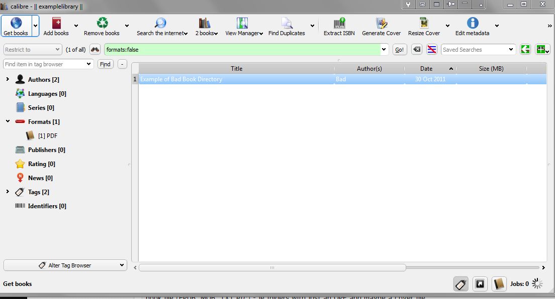

If you click on Formats in the Tag Browser a couple of times until its a red Minus sign you should see all the books with no valid book file (EPUB, MOB, TXT etc) - ie folders with just an OPF and maybe a cover file.
See piccie

On my system the Format Tags are "automatic" in that I don't have to do anything other than to add or remove files of recognised formats to a book to update the Formats section of the Tag Browser.
Hence a search of formats:false (which is what the Red Minus on the Formats Tag equates to) will show all 'books' that don't have any known book format files.

If you want to find book entries that have no associated ebook format then you can search using
formats:false
You can then decide if you want to remove the identified book entries from the Calibre database.

From what you indicate: You have a 'clean library'. By 'clean', Calibre acknowledges that there are books without any formats (just the cover that Calibre shows you and the metadata backup file)
If you want those all GONE.
Search: formats:false
Select all (results)
Tap the Delete key

The 'formats:false' was the key that i needed.
