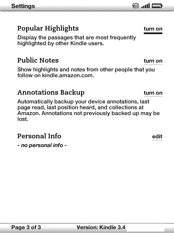

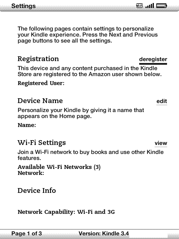

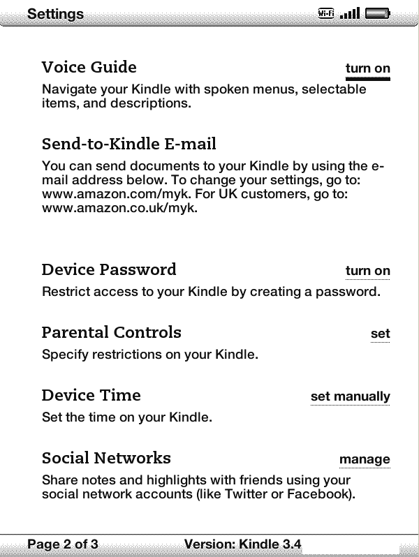

So guide complete. 3.0.2 -> 3.4 on a budget
ID:	92259   Click image for larger version
ID:	92260   Click image for larger version

Next up... 3.4 BR.
A looksee at the defconfig and busybox config to see if they diff anything interesting. (hopefully not)
Get a device that can support the entire tree so I can rollout some of the cooler stuff too. I found a few cheaper old devices that I might grab for testing on. I really don't NEED another average reader, even the "PaperWait" will be a few weeks (If I got an imported one)
ho hum
Well. We have definitely "covered the bases" for the Kindle keyboard in terms of getting a solid platform to jump from.
I think we can *probably* say that will be the last update for the KB in a very long time, possibly ever, so now is a great time to split out the BR go for a 3.4 branch.
well anyway, that took about 8 hours longer than it might have done.
Documentation. A highly thankless task that I benefit from everyday so it's good to do ones part.
3.4 Yay! What does it give me? err almost nothing, nice fonts YAY! that'll do
