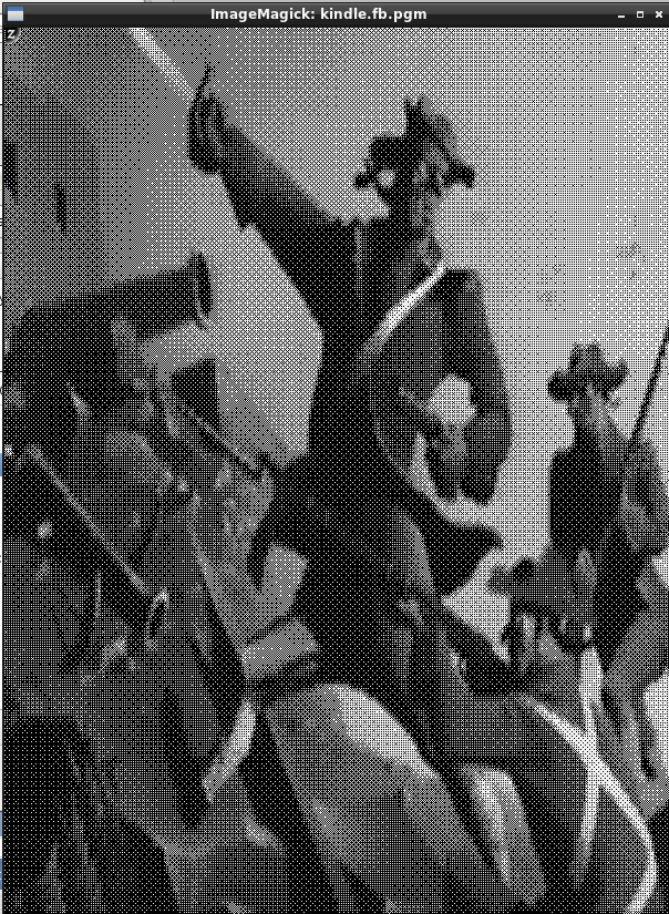

root@kindle:video> ffmpeg -i ./pluto.avi -pix_fmt gray -r 15 -f rawvideo -s 800x600 -|./raw2gmv > output
ffmpeg version 0.8.12, Copyright (c) 2000-2011 the FFmpeg developers
built on Sep 2 2012 03:36:07 with gcc 4.2.1
configuration: --enable-cross-compile --cross-prefix=/home/you/GIT/buildroot/output/host/usr/bin/arm-none-linux-gnueabi- --sysroot=/home/you/GIT/buildroot/output/host/usr/arm-unknown-linux-gnueabi/sysroot --host-cc=/usr/bin/gcc --arch=arm --target-os=linux --extra-cflags=-fPIC --enable-static --enable-shared --prefix=/usr --disable-avfilter --disable-doc --enable-gpl --enable-nonfree --enable-ffmpeg --enable-ffplay --enable-ffserver --enable-postproc --enable-swscale --enable-indevs --enable-outdevs --enable-pthreads --disable-zlib --enable-armv6 --enable-armvfp
libavutil 51. 9. 1 / 51. 9. 1
libavcodec 53. 8. 0 / 53. 8. 0
libavformat 53. 5. 0 / 53. 5. 0
libavdevice 53. 1. 1 / 53. 1. 1
libswscale 2. 0. 0 / 2. 0. 0
libpostproc 51. 2. 0 / 51. 2. 0
Input #0, avi, from './pluto.avi':
Metadata:
encoder : Lavf52.94.0
Duration: 00:00:55.01, start: 0.000000, bitrate: 1012 kb/s
Stream #0.0: Video: mpeg4, yuv420p, 320x234 [PAR 254:255 DAR 8128:5967], 24 tbr, 24 tbn, 24 tbc
Stream #0.1: Audio: mp2, 22050 Hz, stereo, s16, 64 kb/s
Output #0, rawvideo, to 'pipe:':
Metadata:
encoder : Lavf53.5.0
Stream #0.0: Video: rawvideo, gray, 800x600, q=2-31, 200 kb/s, 90k tbn, 15 tbc
Stream mapping:
Stream #0.0 -> #0.0
Press [q] to stop, [?] for help
frame= 826 fps= 3 q=0.0 Lsize= 387188kB time=00:00:55.06 bitrate=57600.0kbits/s dup=0 drop=493
video:387188kB audio:0kB global headers:0kB muxing overhead 0.000000%
root@kindle:video> cat output | ./video
717 frames in 108.4 secs = 6.6 FPS
Would be nice to get the audio stream in now...
You screenshots look like negative images. What happened there? Is it negative on the screen, or is that just in the framebuffer? Some of my eink driver code uses negative images and lets the eink controller invert it, so if your screen appears correct, you need to invert the framebuffer when you convert it to an image file.

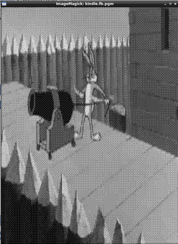

ffmpeg -i http://archive.org/download/BunkerHi...kerllBunny.mp4 -pix_fmt gray -vf transpose=2 -vcodec rawvideo -f rawvideo -r 7.8 -y -s 600x800 - |./raw2gmv | nc -l 5555
was the magic formula for me.
Thanks for all the pointers, don't know why it failed before.
I have been doing -r7.7, which is closer to the 130msec/frame that gmplay uses. Using -r7.8 will make it play slightly slower. That -r15 you used earlier is about half-speed, which works fine on the K5 (with an adjusted gmplay that can play faster), but a K3 cannot go that fast.
In fact, on a K4/K5, you do not need those "nc" commands -- you can do it all on one command line inside the K5. A K3 cannot do the conversion AND the playing at the same time because the eips call uses too much CPU time in a K3 (hence piping the dithered stream from a host PC for realtime streaming, or two-step conversion to a .gmv.gz file like those in the first post).
I see that the screenshots are the proper polarity now (not negative images).
You do not need to rotate (transpose) the image with ffmpeg because that is already done inside the raw2gmv (by swapping scan coordinates). Your aspect ration is messed up. Try removing the "transpose" parameter.
