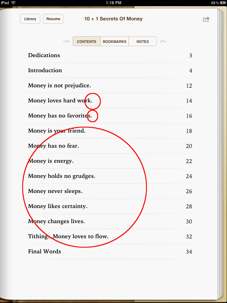

I compiled an epub using Sigil, the file passed validations on Apple, Lulu, Amazon etc. I'm looking at the book on my IPad and I see in the TOC there are periods after titles of certain chapters. I looked in the content.opf and the toc.ncx but do not see the periods. The actual chapter pages do not have the periods only the doc does, see the screenshot, any help?

Sounds like another iBooks quirk.
How does it look in ADE?

Guys I have some mixed replies as I had two posts and when I replied to one it was wrong so just to re cap here is my problem.
ralphiedee
text problems Sigil?

How do I correct as the client sees the periods but only in the toc.
any help?

OK thx for this but it is not a fixed layout epub, so I see periods after some of the titles in the TOC while looking at the epub on an IPad AND iPhone, but do not see the periods in the TOC inside ADE either so if it's not Sigil then what is the problem?
It was mentioned above: probably one more quirk of iBooks.
I noticed from the image that iBooks is apparently generating page numbers to go along with the ToC entries, so there's obviously some extra stuff being generated that's not part of the NCX file. Perhaps someone in the "Workshop" forum or the general "ePub" forum (or even the Apple devices forum) has run into the issue and knows a work-around? Nothing in your attached ePub looks out of order to me.

There are no periods in the titles in the book. iBooks is obviously adding them on its own on lines with more than one word (not capitalized). Note that only "Dedications", "Introduction" and "Final Words" have no period. Try changing "Money loves to flow" to "Money Loves to Flow" (or maybe "Money Loves To Flow").
