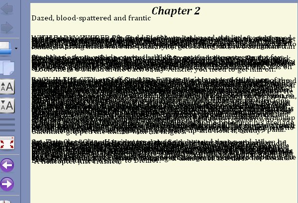

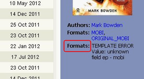

Hi' I have a major problem here. Firstly every file I try and convert shows "Template Error"sign just above the "Converting Widget" in the Calibre GUI (see attach 1)
If I try and convert any file like Mobi to remove double spaces before Paragraphs etc it comes out unreadable" just a scrambled "Blob" of Ink (see attach 2). Even in default mode the conversion of this book fails I have put it on my Kindle without trying convert or to remove the double and triple spaces between Paragraphs and nothing selected in "Look and feel" or any other place. and it works fine except for the huge spaces between Paragraphs! I do have all of my margins set at 2.0 pt and top of page at 3.0 pt. Can some one help please cheers Dasha

Setting a "line Height" to a number under '1' will overlap lines.
That looks to be a severe case

Thanks theducks" Okay I have adjusted that Line height
Can you please tell me what "Template Error" message is on the right side of the Calibre GUI (see Attachment 1) its allways there??)

It means you have a custom column with an invalid template.

Judging from your attached image, you created a custom column with the title Formats. That would be the column where your invalid template is located. The name directly next to the Template Error is a clue (see attached I circled it in red so you won't miss it.) The template for the custom column called Formats, by default creation, looks like the attached (again circled in red for your convenience.) I'm guessing your template is messed up. Either fix the template or go to Preferences - Add your own columns and delete the custom column (see attached).
Alternatively if you don't want to deal with the complication of fixing the template or deleting the custom column you can go to Preferences - Look and Feel - Book Details tab and uncheck the second Formats you find in the list (see attached, labeled and circled in red to remove all doubt.)
Good Luck!
