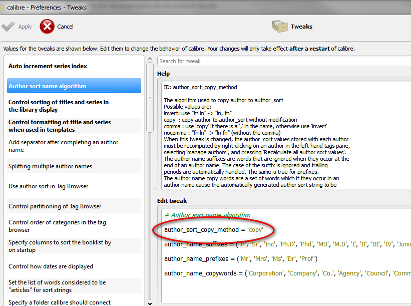

Instructions in response to the original post, condensed:
Originally Posted by paw3pals View Post
First, do the below (which should also make all future author's names listed as LN,FN):
Go to Preferences, then select Tweaks (on bottom of page).
Click on Author name sort algorithm in the left column.
In the bottom right, make it say author_sort_copy_method = 'copy'.
Click Apply and then close Preferences.
EXIT CALIBRE AND THEN RESTART IT AGAIN.
See attached image below
Remember to clic 'Apply' before leaving each changed tweak.
Originally Posted by kiwidude View Post
The step you have just taken of modifying Tweaks just means that whenever you add a *new* book to calibre (or rename an author for an existing book), that whatever you type as the author will be copied to also be how that author sorts on screen.
So that if you type "Bloggs, Joe" as an author, it is going to *copy* the same value into the author sort as "Bloggs, Joe" for it.

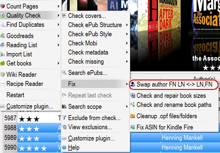

Originally Posted by dwanthny View Post
Install the Quality Check plugin: Preferences - Plugins - Get new plugins.
After the plugin is installed, restart Calibre.
Then select the books you want to swap FN, LN > LN, FN then select the menu item as shown in the attached image. Further info is in the Quality Check plugin help section.
Or, as stated in the first reply in this thread:
The Quality Check plugin has a FIX subsection the swap is just one of them.
Highlight (select) the problem kids, invoke the Fix
When downloading metadata, make sure you have the "Swap author names from FN LN to LN, FN" option checked if you are overwriting the Authors field.
Brief summary:
(1) Put that pesky tweak back in to say "copy".
(2) Install the "Quality Check" plugin, using Preferences -> Get Plugins
(3) Any time you see books for an author that are FN LN in the library view, select them and choose Quality Check -> Fix -> Swap author FN LN <> LN, FN
That's all there is to it. No copy/pasting required.

When you add a book, the author's name is listed however the publisher put it, so there is no way to control that.
However, if you download metadata (which I almost always do, as that gives me series info) you can specify LN,FN. Go to Preferences, Sharing, Metadata download - in the bottom right make sure there is a check in the box for "Swap author names from FN LN to LN, FN."
Originally Posted by Lady Fitzgerald View Post
Edit2: I changed the preferences back to the default and tried going to the metadata editor after adding a book, then just copying the author sort field and pasting into the author field. That was a considerable improvement over having to retype the author.
So, I'm back to asking, is there any way to get calibre to automatically put LN, FN in the author field when adding a book without having to change it in the metadata editor after adding the book (if so, then the tweek should work)?
When I add several books, I highlight all of them, then go into the Metadata editor and edit them individually. To get the metadata, I used to copy the ISBN from the title field, paste it into the ISBN field (now the ID field), then download the metadata. That almost invariably results in the author being entered as FN LN. If the tweek is in place, I would have to retype the author as LN, FN. Without the tweek, all I have to do is click on the box to the right of the author and hold it a whole half second until the menu comes up, then click Copy Author Sort to Author (faster than the copy/paste I was going to use). I then move on to the next book until I've updated all of them, then hit OK.
^^ Don't forget...
That will save you most of what you talk about in your post that I've just quoted. Downloading metadata will give you LN, FN automatically. Imagine that!
EDIT: Oh, I missed paw3pals' post saying the same thing. Can't do any harm to repeat it anyway (again).
