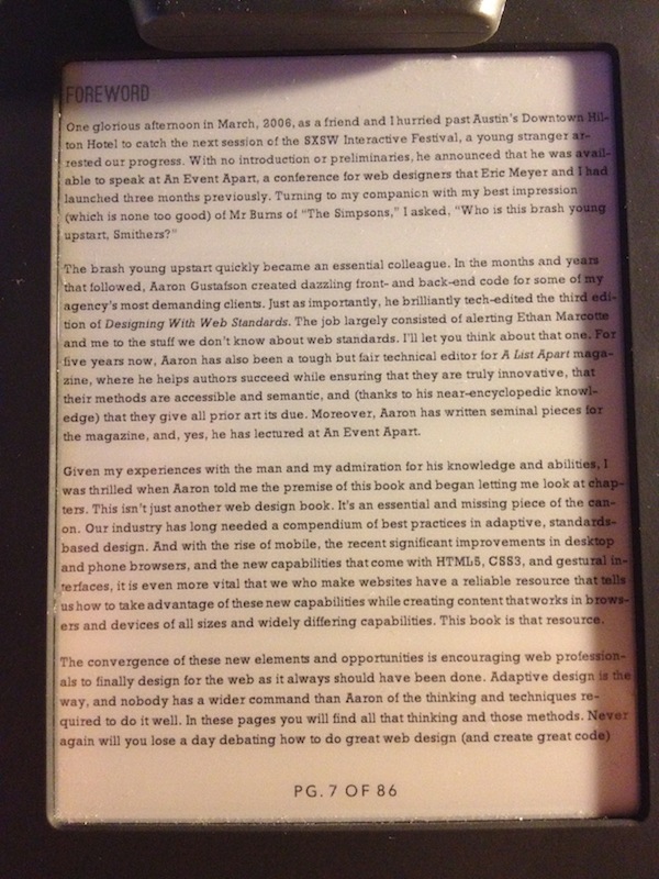

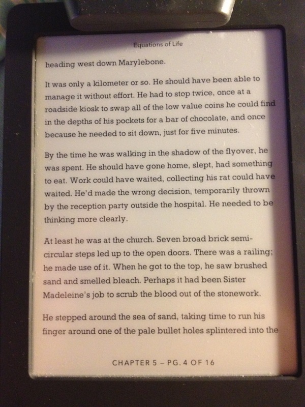

Before I try a factory reset, is anyone else having a huge font size/text size discrepancy between sideloaded epubs and kepubs in 2.0? I'm using the later version, just updated last night.
As soon as I updated, I opened a kepub and it looked like I was reading a large print book. My settings hadn't changed but it seemed like Kobo's type scale did. If I bump the kepub font size down to a reasonable size, then sideloaded epubs show up tiny and unreadable. This is similar to the margin discrepancy but it's probably about 3 levels of font size difference between kepubs and epubs.
I searched the thread but couldn't find any other reports about this issue.
Attached are two images, the first showing a kepub, the second an epub. Exact same font settings for both.
ID:	89297   Click image for larger version
