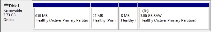

Ok. At last I could be able to recover the password! The password was the one generated for "4.0.1", not 3.0 here:
http://members.ping.de/~sven/kindle.html
This is the disk I see now in Windows Disk Management:
I want to dump the provided images on the partitions.
wlaf is offline   Reply With Quote
That "report" is only showing the file system contents of the one file system type it recognizes (blk0p4, FAT-32, a.k.a: USB-storage).
It is just a pretty GUI picture of the partition table, plus it has detected and auto-mounted the FAT-32 partition.
You will have to load an ext2/ext3 driver for your Windows box to recognize the first three.

Even after loading the Windows ext2/ext3 driver, Windows Disk Manager will only show you the file system contents.
We want the storage media contents that underlies the file system.
You will have to try some of the Windows "Disk Clone" and/or "Disk Backup" loose in the world to get storage media contents.
I will do the job by attaching the USB to the Linux Box I have in VMWare. The rest of the job seems to be straightforward in Linux. There is also several versions of "Windows DD" availabe, but I prefer Linux.

And at last...We're Back!! :-)
Reading was so fast, but writing the image was slow and made me worry:
Making Backup:
root@ubuntu:~# dd if=/dev/sdc1 of=kindle1.img
1331256+0 records in
1331256+0 records out
681603072 bytes (682 MB) copied, 61.8736 s, 11.0 MB/s
root@ubuntu:~# dd if=/dev/sdc2 of=kindle2.img
49152+0 records in
49152+0 records out
25165824 bytes (25 MB) copied, 2.65295 s, 9.5 MB/s
root@ubuntu:~# dd if=/dev/sdc3 of=kindle3.img
16384+0 records in
16384+0 records out
8388608 bytes (8.4 MB) copied, 0.691376 s, 12.1 MB/s
Dumping the provided image
root@ubuntu:~# dd if=mmcblk0p1.img of=/dev/sdc1
681603072 bytes (682 MB) copied, 634.65 s, 1.1 MB/s
Now the Kindle is up and running! :-)
Thank you guys, for your help.
Do you think that the same root password should work now?
