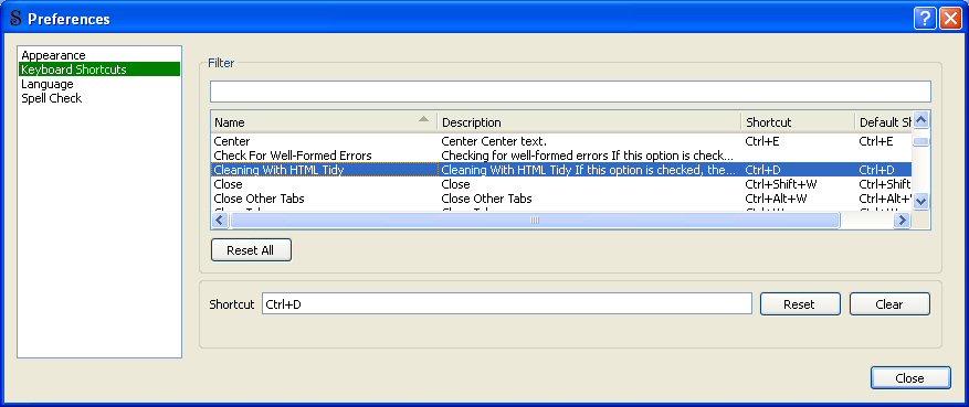

Can anyone tell me if keyboard shortcut can be turned off or not?
You can change the preference for it to other keystrokes or Nothing.

Device: Kobo Sage, Kobo Aura H2O, LG V20
Do you mean the word ‘Nothing’? If I choose Clear, the shortcut appears to be gone, but comes back the next time Sigil is started.
Clear
Does the same here (Sigil 5.1 on XP SP3)

Because when you click Clear, you are clearing the edit box and your custom shortcut. Since you've cleared the custom shortcut, the default shortcut will be used.
If you want to avoid using the shortcut, just change it to something harder to press accidentally.

That's not the way most programs work. You have every right to do it that way, but I think you should expect people to be puzzled. Usually a null or empty setting means just that. Making up some weird key combination seems a little crazy or at least non-intuitive.
There are other commands listed that don't have shortcuts. How does that work then?
I am with you. This interface is strange.
Why have a Reset (which copies the default) and let this happen anyway, if there is a default value and the field was left blank?
BTW I did manage to set it to Ctrl+Alt+6 (not too much chance I will fumble that one )
