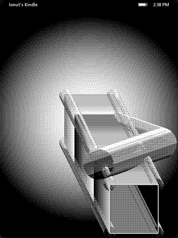

The animation was fast. Quite a lot of fps. I like where this is going. Who said eInk is slow?

cosmegg - geekmaster cosmic egg demo
Another "geekmaster formula 42" demo. And another one you can guess from its name.

Really nice demos. On my K3, 50% of the CPU time is spent in the Kernel (according to unreliable "top"). Probably, the eink driver could be a bit more optimized...
[root@kindle us]# time ./cosmegg
real	3m 56.15s
user	2m 9.67s
sys	1m 46.24s
The Moiré effects in the Cosmegg demo are nice :-)

<<What is your opinion about my SOURCE CODE? Do you like these C proggies better than my /bin/sh scripts?>> geekmaster
This is such a personal question... my 2 cents: I find your code compact and elegant. Though C is more powerful and easier to understand, Shell is more fun (minimalist language demanding plenty of ingenious techniques). In my opinion compact code can sometimes be cryptic (e.g. APL ) but verbose code can quickly become boring (e.g. COBOL ). Nothing that should scare beginners away -- to the contrary. Your spectacular demos will set interested minds in motion. Thanks for sharing them.
... And by the way I liked the cosmic egg hypnotic screen effects:
Are you sure?
Really sure?
Then Click At Your Own Risk:
