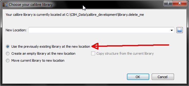

Originally Posted by itimpi View Post
Actually I thought that the response said that there was no limit to the number of libraries - the limit applied to the number displayed in the list before any new ones ahve to displace an entry. Nothing to stop you navigating to one that is not on the list (and then that would make the last entry drop off the list).
How do you do this? I tried the SWITCH/CREATE and when I navigate, it just gives me the option of creating new, etc.
When I make a folder, even though it doesn't appear in the list, the folder IS in the calibre library if I go to the calibre folder on my computer.
Peekamoo is offline   Reply With Quote
When I click on switch/create, I see this dialog:
The red arrow points to the choice that permits you to open an existing library. Navigate to a library using the New Location box, press OK, and the library will be opened.

Thank you, thank you! I will do that!
