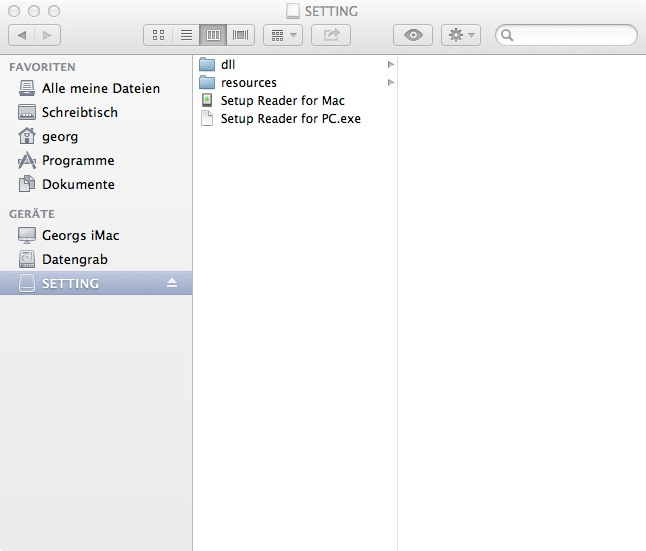

hello all,
I seem to have a similar USB problem with the PRS-T1. Here's the situation:
- PRS-T1 rooted with Rupor's "Minimal Root Package". But since I had issues with hanging device and USB mounting (see below), I unrooted it via SD card
- when I connect the reader via USB, drive "SETTING" is reliably mounted, but "READER" is not --> not a cable issue. Without "READER" partition, I cannot upload etc.
- I have a Mac running OSX 10.8.4, and before rooting everything worked fine
Any idea what I may still try? Any help is appreciated!
Geetings, Georg
PS: here's a screenshot after connecting

problem solved
hello again,
formatting both the SD card and the internal memory worked --> all data is gone, but now I can mount the reader again
Have a nice day!
Georg
