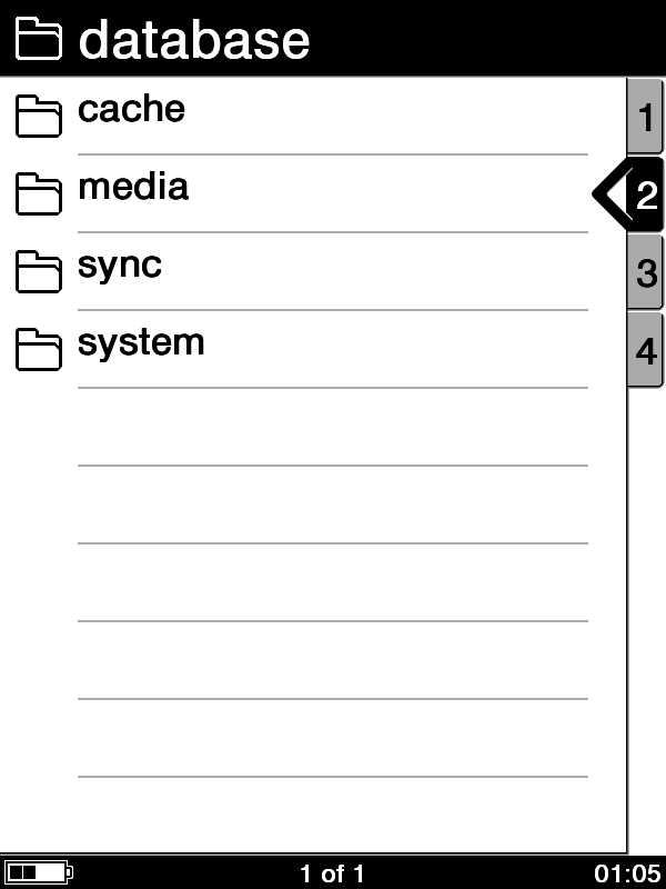

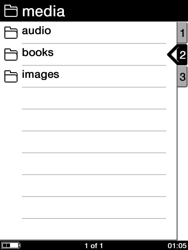

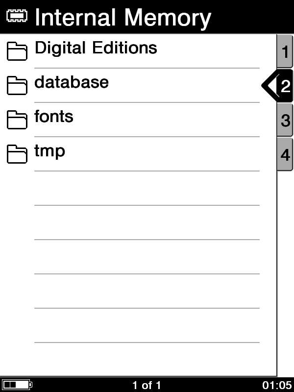

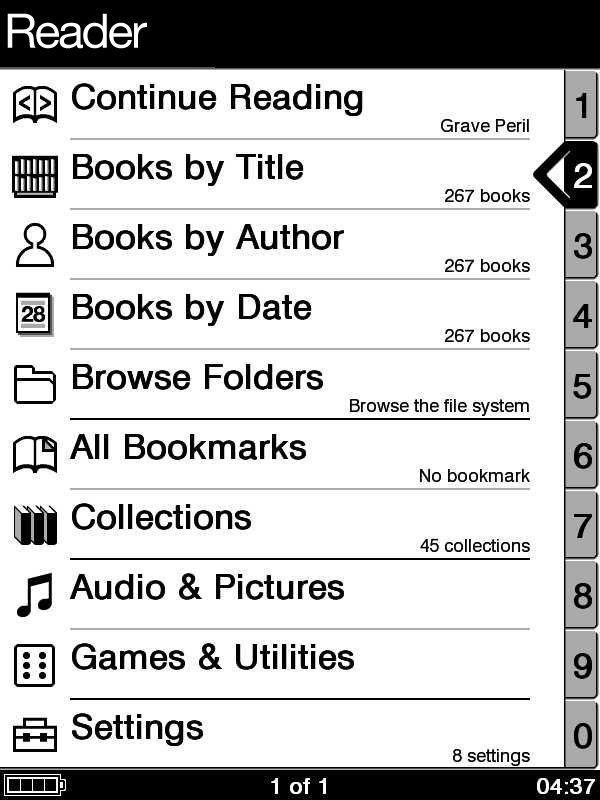

Your correct the Books by Author menu does do first name then last name for authors. There is another option you might want to consider. I use PRS+ on my 505 which allows me to browse the actual folders on the device. When I use the Browse Folders option and drill down to the authors they are indeed Last name first. See attached images.

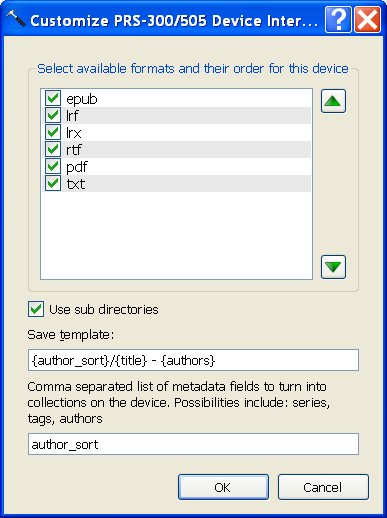

It just occurred to me that Calibre will let you create your collections from the author_sort field if you change the device interface plugin setting from tags, series to just author_sort (see attached) then all of you collections would be based on the author_sort field. In my case all collections would be Last Name, first name - example - Asimov, Isaac.
