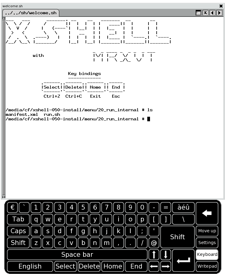

Hi,
I installed xshell and, although it starts and is functional, it creates a file errors.txt in the _xshell\mrxvt directory. This happens with both the installed and the standalone versions (in different mrxvt directories obviously).
The contents of the file:
./xset:  bad font path element (#56), possible causes are:
    Directory does not exist or has wrong permissions
    Directory missing fonts.dir
    Incorrect font server address or syntax
killall: mrxvt: no process killed
mrxvt: can't load font "9x15bold"
the fonts seem to be in the correct place (_xshell\mrxvt\fonts\misc)
Can this error be the cause of just a tiny window with very small font showing up?
Thanks!
Marcel

Interesting... thanks for the bug report!
Is anyone else having this same problem???
The font should be this size.
Let's see...
The line "killall: mrxvt: no process killed" is supposed to be in the errors.txt file. (Note to self: I should have renamed errors.txt to messages.txt.)
The xset error is not supposed to be there, and is causing the mrxvt error, which indeed would cause your font to be tiny.
To Marcel or anyone else having this problem:
If possible, could you please add the line:
echo $fontdir >> ./errors.txt 2>&1
to the end of the _xshell/startxshell file, start then exit xshell, and let me know the directory newly listed at the end of errors.txt?
bobj is offline   Reply With Quote

Thanks for responding
The problem has disappeared... I noticed a few other forum topics where problems disappeared the next day, but I guess I can add one to that list. I did reboot a few times to no avail, waiting untill the next day did the trick. Mysterious...
To complete the issue, I did change the shellscript upon your request, this is the new errors.txt:
/media/card/ZZZ_Installs/xshell-050-install/_xshell/mrxvt/fonts/misc
Just what I would expect.
