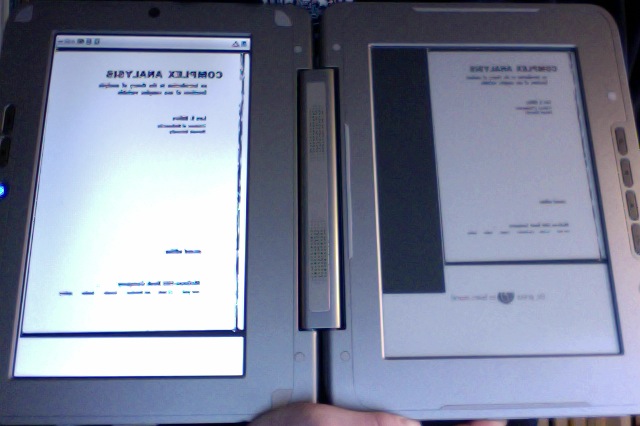

unfortunately still not, rotation still a problem and only half page is being displayed, sorry !
(refers to version 4)

no, with the rotate button on the lcd side, if I am not using this button at least once, almost nothing appears on the-ink side,
after this, when rotating with the orion menu option, the displayed picture stays in the upper half and rotates along with the one on the lcd side, with a difference of 90 degrees in what is being displayed ...

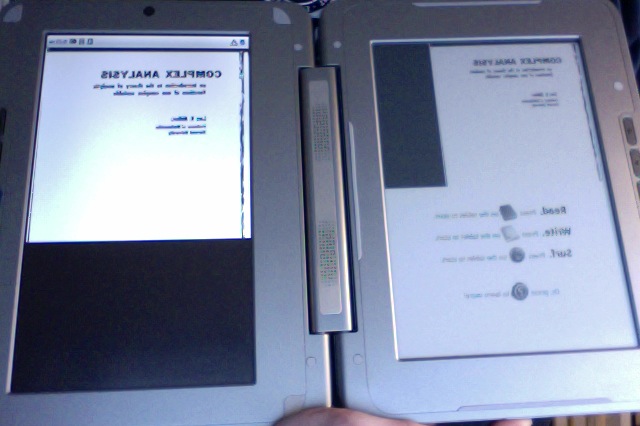

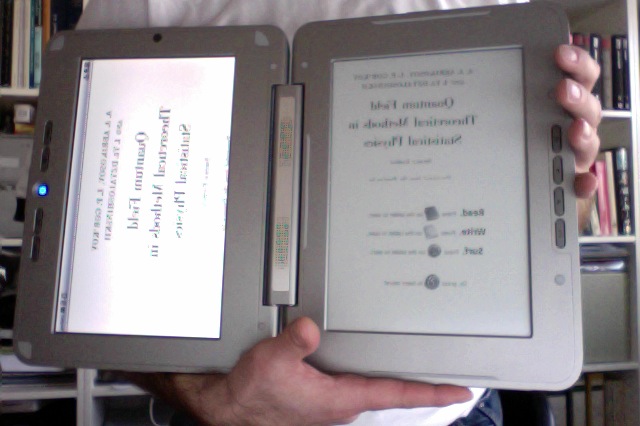

rotation is perfect now, remaining problem: the book displays perfectly on the lcd side, but the e-ink side is not fully used, and it should be the opposite, will attach some pictures ... getting there !
(the second picture is from coolreader, where the text does not fit completely on the lcd side, but fills entirely the e-ink side ...)

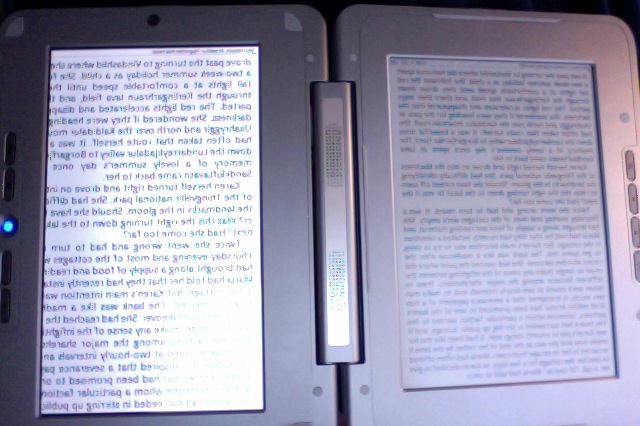

the lcd side is now cut as well, only half the page appears, unfortunately there is no change on the eink side ...

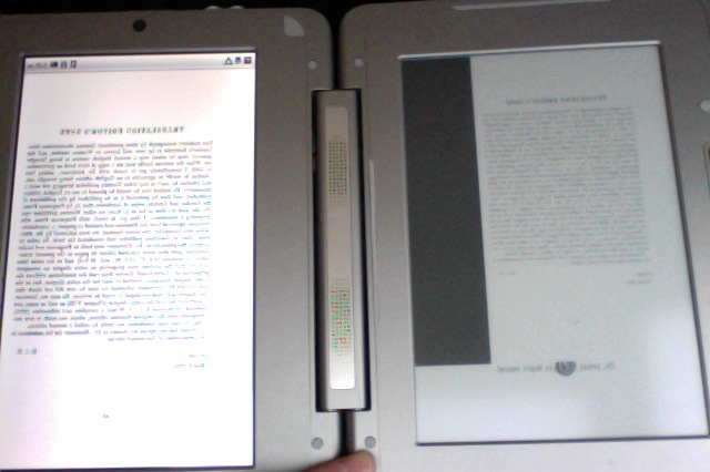

in width, you are now using 10,1 out of 14 cm's
in height, 16,7 out of 20,3 cm's
