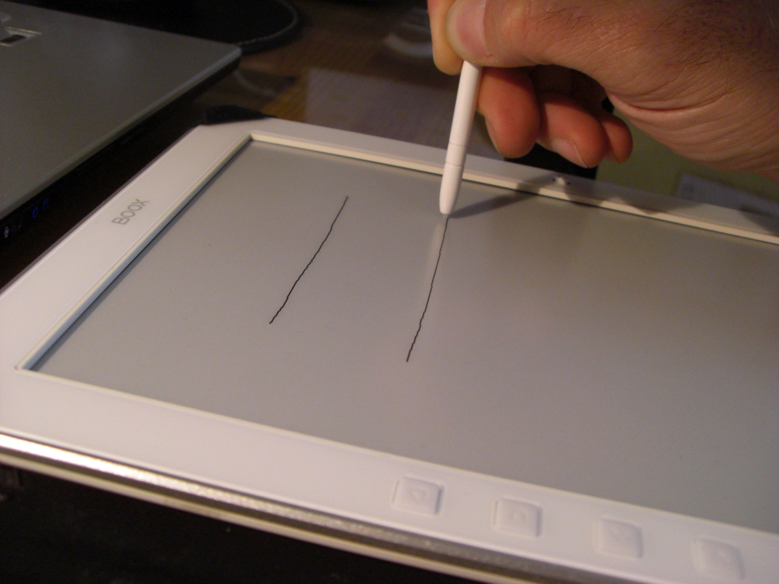

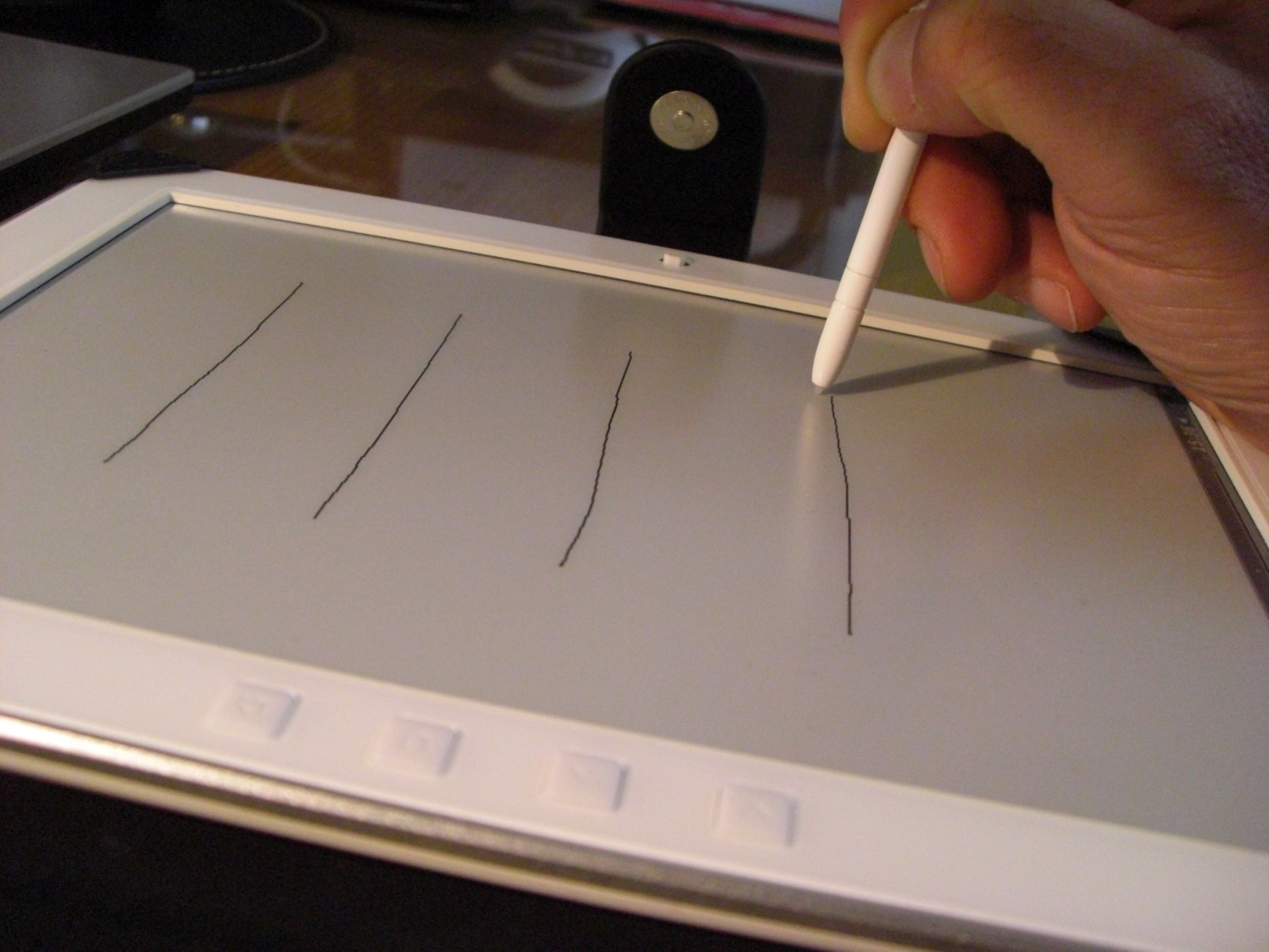

Originally Posted by Booxtor View Post
Hi,
Could you test if the scribbling inaccuracy happens in books during annotations or also in the scribble software too? It is actually unusual behavior. I have tested a couple of M92 (with original and black pens) here and couldn't reproduce the described issue. And I did not calibrate the device - just installed 1.7.
May be additional recalibration helps?
Thank you:
Yes, I have tested everything. See the pictures... I will try to explain it. My apologize if my english is not good enough.
See the difference between the lines. At the top of the page, the pencil tip is just where the line is. But when I start moving down the screen, the distance between the tip and the line increases. And... only writing horizontal lines, not with vertical ones.
RAFA

It is a lot. I had at most 1-2 mm in 1.6 firmware (where was some problem with calibration - I didn't use fix provided by one of users).
In 1.7 release candidate it is much better. Almost like a pen. I can write without any problems. It writes where I expect it to write.
It seems to me you the calibration of the pen is not correct (or there is the hardware problem).

Originally Posted by ragasol View Post
Thank you:
RAFA
Looking at the pictures, I can see that you
a) attempt to hold the pen vertically for drawing the lines, and
b) tilt the pen downwards on the lower lines. This is consistent with my hypothesis.
Please mind that the angle you hold the pen in calibrating and writing is very much relevant... and as you have 5 calibration sample points from which other the points are interpolated, the effect not being consistent on the entire screen makes perfect sense.
Either calibrate the pen holding it vertically on every point and always hold it vertically (very unconvenient from my point of view),
or always calibrate it at the different points holding it exactly as you would writing at these points and never hold it vertical for writing.
I've got very good results with the latter on 1.7RC firmwares.
If you try otherwise, mind that the tablet is _not_ locating the tip, but the sender above the tip.
Update: Maybe this helps to make my point understandable http://community.imaginefx.com/forum...ad/303831.aspx

Thanks:
I calibrate the stylus carefully, but is not easy to do. The first cross is easy to calibrate, but the other four are not. I have to try several times. Always using 1.7 firmware...
RAFA
Thank you:
RAFA
Hi,
as I can see it is something wrong with the calibration of the lower part..
Try to calibrate lower part (lower two points in calibration screen) incorrect on purpose and test, if the behavior of scribbling has been changed afterwards..
Hi,
Hi Booxtor:
I have been calibrating wrong on purpose, and there is no improvement.
It is really difficult to calibrate. First point is the only one has to be touched once. Maybe there is a hardware problem.
RAFA
ragasol is offline   Reply With Quote

Booxtor didn't mean, that wrong on purpose calibration would fix your problem.
The aim was to find out if calibration does something (in your case). If you do it wrong on purpose, the result should be wrong (to the same extent). If you do calibration less wrong, drawing should be less wrong...
It is not easy to do calibration (at least in my case). Some points are easy, some difficult. Sometimes I have to try many times (more than 10-20) on one point.
I might do something in wrong way....
Anyway, at last everything works fine and pen writes quite precisely. Offset less than 1 mm (I guess).
What firmware do you have? I am not sure, but I think that 1.6 didn't use calibration at all or not suffitiently. 1.7 RC should be OK in this respect.
