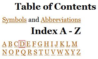

Is it possible to create a "dictionary" format in epub (for sony reader) with a look-up function (using i.e. wordsearch).
AFAIK, this would require rooting the firmware and installing custom apps.
What you can do is create an ePub dictionary with a comprehensive TOC. For an example, have a look at the free MS Reader Dictionaries. (Since they're not DRMed, you can deflate them with ConvertLIT.)
The main TOC of these dictionaries contains links for each letter of the alphabet. When you click a letter a sub TOC page is displayed that narrows the letter range further down. For an example see the screenshots of the Italian-English MS Reader dictionary.

Thank you Doitsu. that is sort of what I was looking for and the alphabet TOC was what I figured I would need.

A few years back, I created a huge epub dictionary, Webster's Dictionary 1913 and settled on a Summary TOC (just the letters ABC..) supplemented by a more detailed TOC inspired by those MS Reader Dictionaries and my own experimentation. I still continually tweak it and will update it once the epub spec incorporates better dictionary guidelines. I have my own ideas, but without ebook reader software search engine/lookup it could never be used as you would want to use it!

Had you read my posts more carefully and actually looked at the screen capture of the MS Reader dictionary TOC you'd have noticed that the TOC does NOT contain a link for every single word, but word ranges, which is quite manageable.
