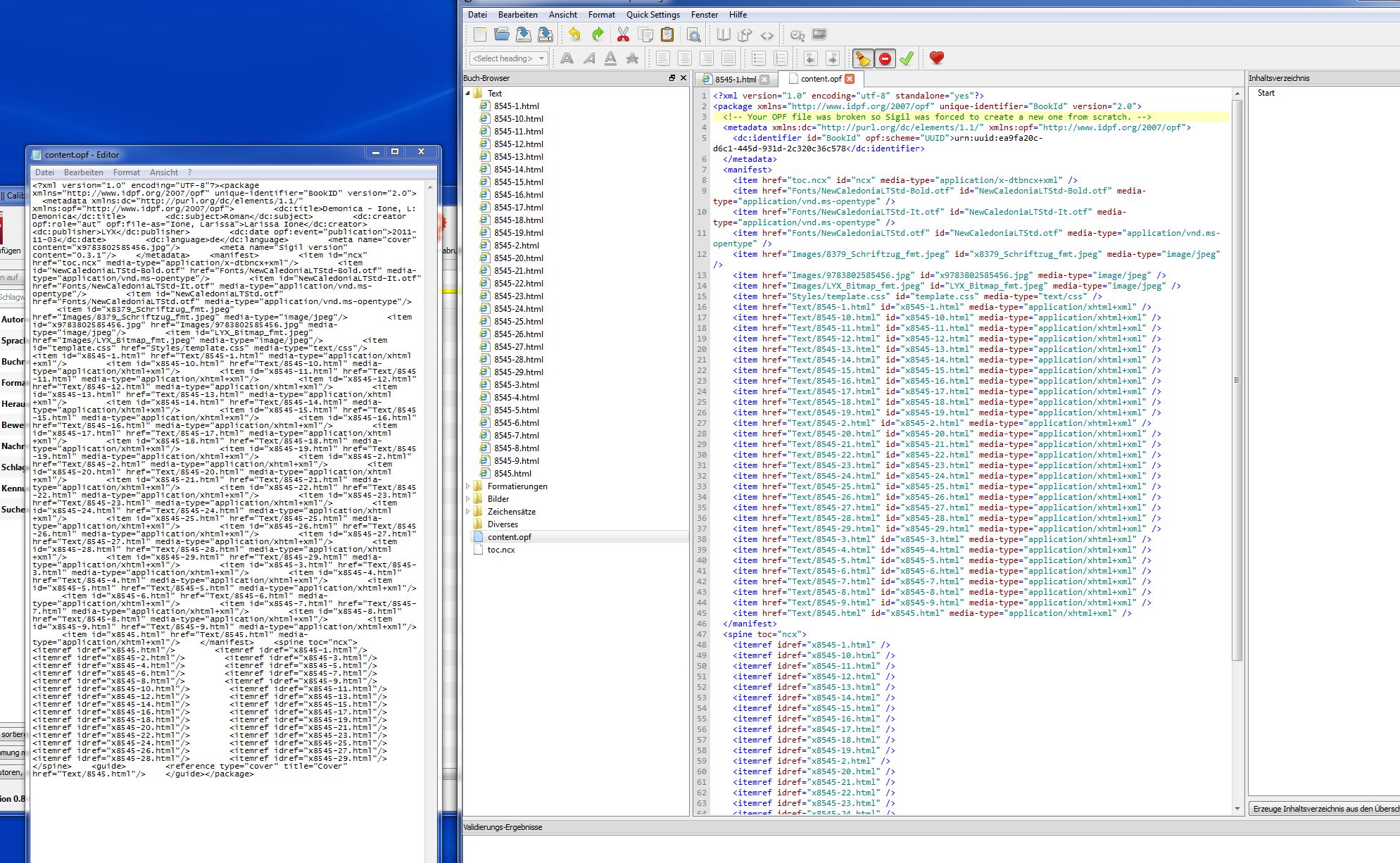

thanks for your reply ! I've added a screenshot so you can see what happens. To the left you see content.opf of the epub file as is. To the right you see what happens when the epub is opened with Sigil

I don't see an issue with your book id, so it seems yovalentinesur content.opf is corrupt for another reason, or at least corrupt according to Sigil.

It opens with Sigil 0.34 without problems, actually it was created by Sigil 0.3.1 (as you can see from the metadata).
The issue is, that the original content.opf does not have any bookId, so Sigil >=0.4 rebuilds the file from the scratch without warnings.
Same happens when I want to change the BookId on any epub from UUID to ISBN within Sigil.

Why is the <dc:identifier> metadata element being changed or removed in the first place? Your original ePub indicates that it has a unique-identifier in the <package> element, but then no unique-identifier is found in the metadata. A valid ePub requires the dc:identifier, dc: language and dc:title elements. So your example ePub is just not valid right from the get-go (regardless if past versions of Sigil let that slide).
Are you asking for Sigil to maintain your ePub's invalid opf status upon first opening? Or are you asking for Sigil to be able to account for the myriad of ways an opf can be invalid and fix it in a non-destructive manner?
It opens with Sigil 0.34 without problems, actually it was created by Sigil 0.3.1 (as you can see from the metadata). Same happens when I want to change the BookId on any epub from UUID to ISBN within Sigil.
If you want to switch to ISBN, then you need to change the scheme to ISBN in the opf file before saving and closing, just deleting the <dc:identifier> element and reopening won't work.
Change the <dc:identifier> element from:
<dc:identifier id="BookId" opf:scheme="UUID">urn:uuid:731aae73-ffff-469e-a5f6-b9c0ebca3360</dc:identifier>
To something like (with a valid ISBN, of course):
<dc:identifier id="BookId" opf:scheme="ISBN">0123456789</dc:identifier>
And save the ePub. All your existing metadata will be retained and Sigil won't rebuild your opf when you next open it.

The problem is that Sigil versions prior to 0.4 created/tolerated epubs without BookIds. Now when you want to edit the epub with a later version, your content.opf is messed up without any warnings. If a BookId is required now thats fine however at least the user should know the opf file is rebuilt from the scratch and the chapters are mixed up in most cases so the book becomes unreadable ...
Thanks for your reply! I think this was the problem - at least it works for me now. So it might well be that I only edited the urn:uuid statement and forgot about the scheme.
