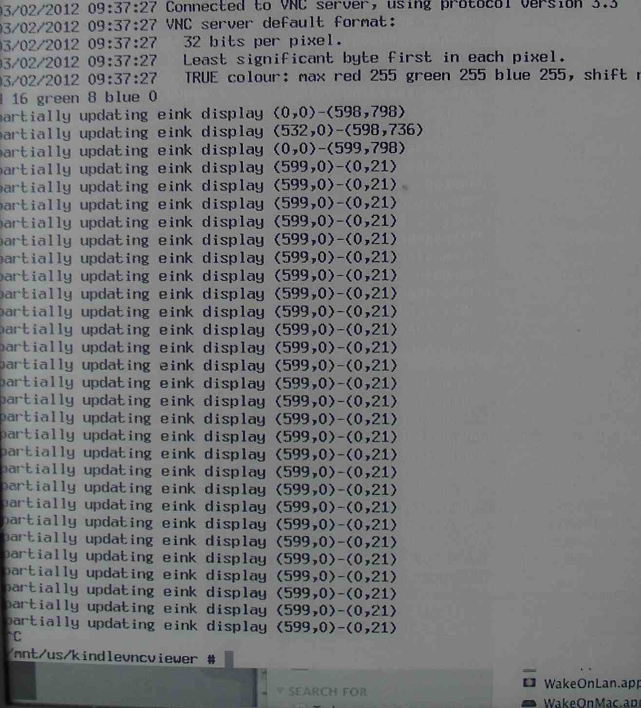

Do you mean one of the forums here?
Originally Posted by fluminense View Post
Running this solved for me (tip from the KindleTerm forum)
/etc/init.d/netwatchd stop
Doesn't seem to help in this case
Sometimes the errors pause (I'm testing this from terminal mode on K3)
& then resume when I move a window on the mac (running vine server because of the Crypto problem using the resident mac vnc server). Pic' attached shows a sample. For a split second after moving a window, the mac screen does appear on K3, followed by the "partially updating..."

Oh! You're running it via the terminal application. Well, unfortunately that wouldn't work - the terminal and the VNC viewer have no way of synchronization. I think running the viewer via launchpad or via SSH/Telnet login is the way to go... The terminal *might* keep quiet if you redirect those debug messages of the VNC viewer to /dev/null, i.e. append ">/dev/null 2>&1" to the command.

Originally Posted by hawhill View Post
Oh! You're running it via the terminal application. ..
Initially I tried it via LaunchPad, but nothing, so tried from terminal so I could see some error output - which I did of course
I don't know why it didn't occur to me that the display would be overwritten anyway! I didn't know about the sync' aspect though.
Thank you Hawhill, your redirection works
