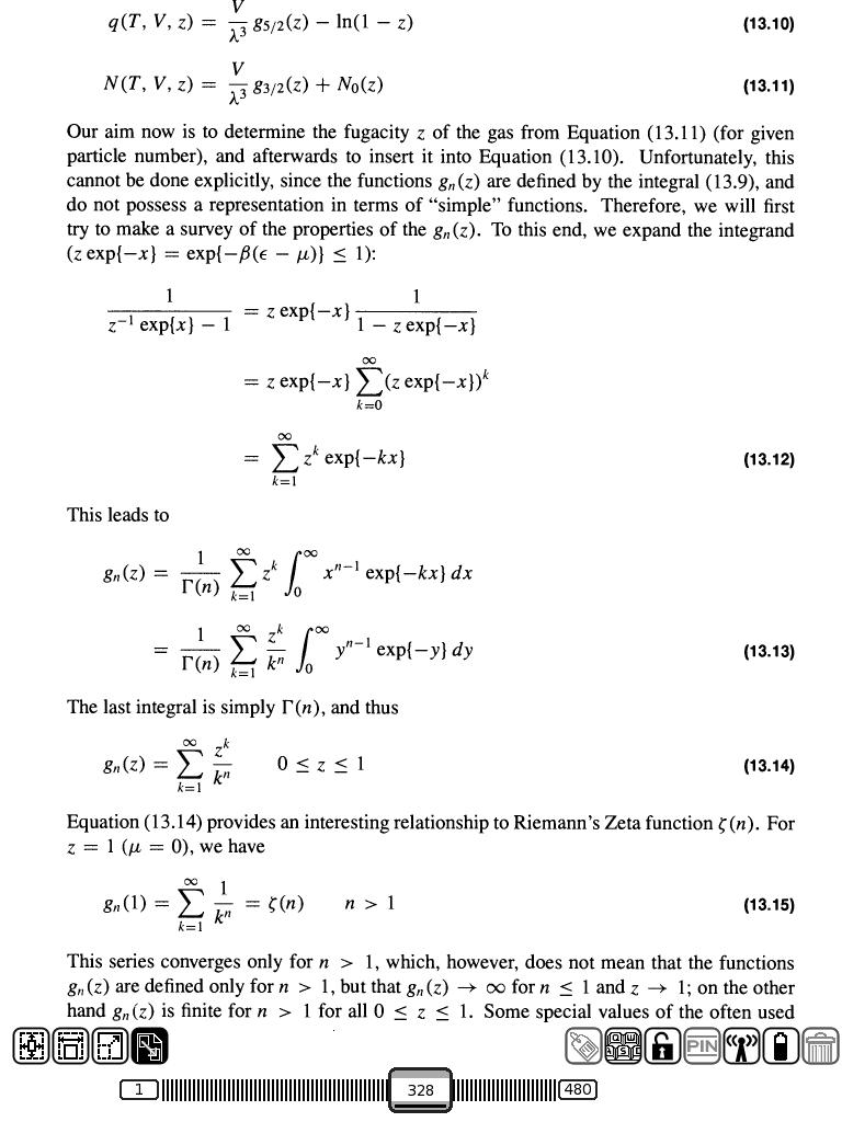

Thanks Martijn, zooming & panning is nice.
#screenshot: javadjvu-0.3 in action.
