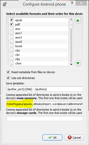

**Kobo Vox Main Memory use with Calibre - Solved**!!!
Hey guys just wanted to let you know I figured this out....
1. In Calibre click the drop down menu arrow beside the Device button
2. Select "Configure this Device"
3. In the "Comma separated list of directories to send e-books to on the device's main memory. The first one that exists will be used" field enter: "KoboPegasus\epubs" as the FIRST DIRECTORY. (Don't forget to put a comma and a space after the "KoboPegasus\epubs" - so the field should look like this:
"KoboPegasus\epubs, eBooks/import, wordplayer/calibretransfer, Books, sdcard/ebooks"
Calibre will now save the ePubs to the correct dirrectory on the main memory - no need for the SD card!! Upload and enjoy!
Hope this helps.....
James
hotshot79 is offline   Reply With Quote
