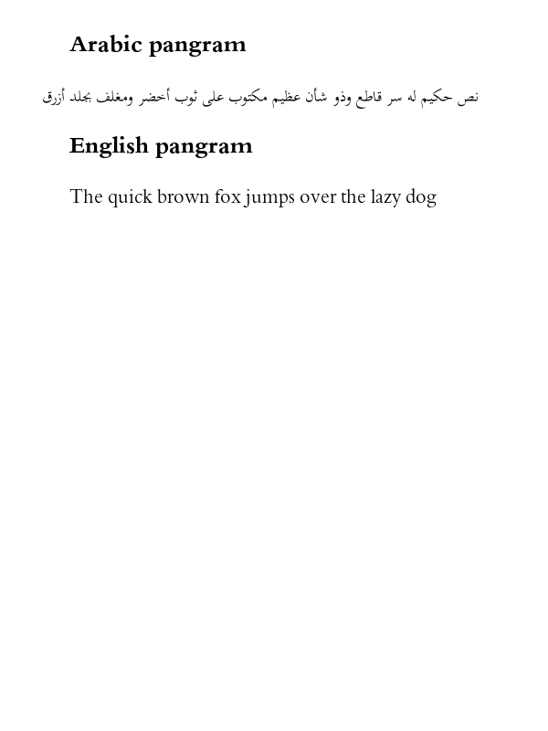

I used traditional arabic font and DLite displayed it correctly
Actually, I embedded an Arabic font in the epub. Theoretically, an ePub reader should be able to display it without having to specify a font. ADE does, but doesn't do RTL and character shaping. I'll do some more tests once I get Duokan Lite running.

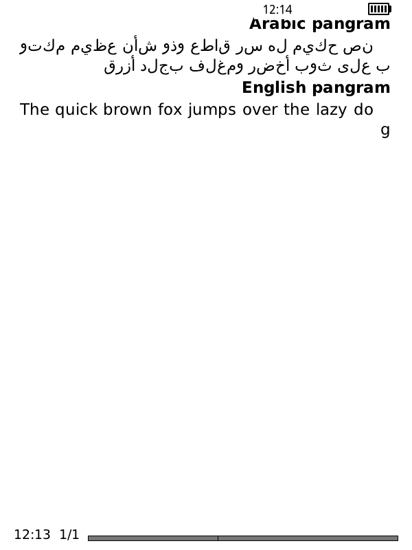

It did display Arabic letters, but they were displayed isolated and from left to right. I.e. it behaved exactly as ADE. (I did change the language to Arabic.)
BTW, I did my tests with Andy Wooden's fbKindle (FBReader 0.12.10)
Please find attached a screenshot that illustrates the problem. The letters should have looked like this:
نص حكيم له سر قاطع وذو شأن عظيم مكتوب على ثوب أخضر ومغلف بجلد أزرق

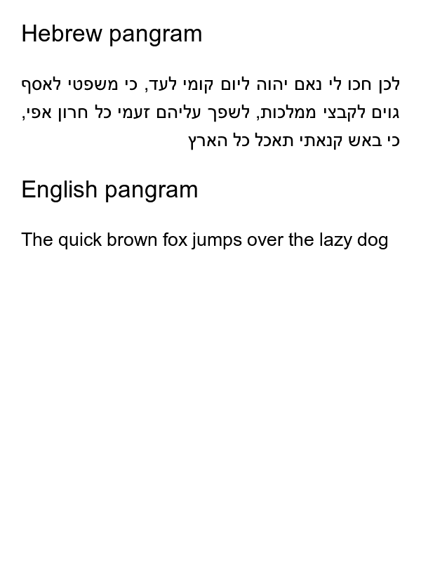

Hebrew seems to work, too. I just tested it with a Hebrew pangram. But since it has been ages since I last looked at a Hebrew text I'm not 100% sure.
Please find attached a simple Hebrew test .epub and a screen capture that shows the Kindle display.
BTW, my installation on a Kindle 3.3 WiFi went as follows:
1. I backed up all my Kindle ebooks and uninstalled the jailbreak
2. I downloaded Lite1014.1225.rtm.rar from here
3. I copied the DK_System folder from the archive to the Kindle root directory
4. I copied the large update_duokan_0b008.bin from the 升级包\k3升级包\kindle3.2.1升级包\ folder to the Kindle root directory (If you don't have a WiFi model, you'll have to pick one of the other .bin files.)
5. I started the firmware update (Settings > Update Your Kindle)
6. After the update was complete, Duokan Lite displayed the Chinese welcome screen. After a while I figured out that I had to select the 5th menu item [S] in the rightmost menu to change the language to English.
7. I connected the Kindle to the computer and copied Arial.ttf from my PC to the \DK_System\Lite\res\userfonts folder. (Arial supports both Arabic and Hebrew).

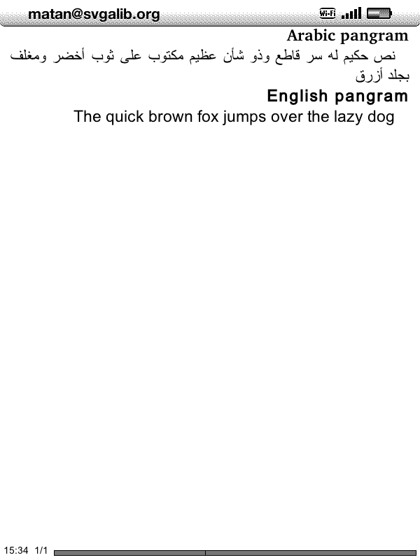

This is how it looks on my kindle. If it is OK (please check), we can try to find out the difference between your and my setups.

The text in your screen capture looks exactly as it should be. Most likely we're using different software versions.
I downloaded fbKindle from here, because I assumed that this is the latest version.
If yours is more up-to-date or you're using a different version, please let me know where you downloaded it from and I'll re-test FBReader.

The font I use is arial.ttf. I copied it to the directory /mnt/us/fbKindle/qtKindle/lib/fonts, and selected family Arial in the Styles tab in Options dialog. Can you try to use the same font?
I use the same distribution of fbKindle, but I replaced the FBReader binary with one I compiled that fixes some line breaking issues in RTL texts. You can download it from here. The downloaded file FBReader should replace the file /mnt/us/fbKindle/FBReader .

I tested Matan's custom version and can confirm that it indeed displays Arabic correctly.
