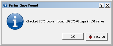

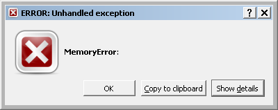

Old 09-18-2011, 09:01 PM   #259
drMerry
drMerry has become one with the cosmosdrMerry has become one with the cosmosdrMerry has become one with the cosmosdrMerry has become one with the cosmosdrMerry has become one with the cosmosdrMerry has become one with the cosmosdrMerry has become one with the cosmosdrMerry has become one with the cosmosdrMerry has become one with the cosmosdrMerry has become one with the cosmosdrMerry has become one with the cosmos
drMerry's Avatar
Posts: 293
Karma: 21022
Join Date: Mar 2011
Location: NL
Device: Sony PRS-650
I love the option.
Thanks
Will have to use it in sub-functions.
I ran it twice. once on my epub files and once on all files.
I got these reports:
log was not available for first notice.
second notice had as log:
calibre, version 0.8.19
ERROR: Unhandled exception: <b>MemoryError</b>:
  File "calibre_plugins.quality_check.action", line 96, in perform_check
  File "calibre_plugins.quality_check.check_metadata", line 39, in perform_check
  File "calibre_plugins.quality_check.check_metadata", line 242, in check_series_gaps
MemoryError
This lib has 17526 books
1764 series
7865 books having series
largest series 239 books
about 600 series with one book (all possible indexes)
5429 books with series_index 0
There seems to be a bug in calibre telling all books to have a series_index (series_index:true returns all books)
6305 books with series_index 1
ID:	76667   Click image for larger version
Name:	qaulcheck bug-full lib.png

Old 09-19-2011, 04:25 AM   #260
kiwidude
Calibre Plugins Developer
Posts: 4,735
Karma: 2208556
Location: Australia
Device: Kindle Oasis
@drMerry - can you zip up your metadata.db and PM me a link as you have done previously so I can run this myself?

Old 09-19-2011, 04:17 PM   #262
kiwidude
Posts: 4,735
Karma: 2208556
Location: Australia
Originally Posted by drMerry View Post
at least someone is happy with my bugs
Who said I was happy?
So as far as I can see there isn't a bug in the plugin, it is just the same issue mentioned above of some "unusual" shall we say series index numbers. So for instance you have a series entry in there of:
De Jonge Lijsters [199304]
So straight away that is going to add 199303 missing numbers in the series. Which combined with other instances of this blows up the logging with the memory error you had above.
I think what I am going to do is out some sort of threshold check in there which will ignore series which appear to not be "start from 1" type series indexes. Easiest will be to take the maximum number in that series, and if it exceeds say 3 digits (i.e. 1000 or greater) then it won't attempt the series gap check and just mention it in the log instead. At the same time I will make a change to cater for duplicate series index values which theducks had in his library.
kiwidude is offline   Reply With Quote
